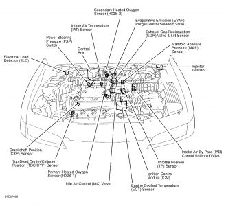

Where is IAC loacted in 97 accord V6 is it possible to get picture here or on email?

The IAC is attached to the throttle body.
https://www.2carpros.com/forum/automotive_pictures/192750_Accord97Component_1.jpg
Don't worry aboout the BS some people out to make a quick buck would throw at you to make you worry unecessarily. With the engine running, how can the carb cleaner get to the MAP when there is vacumn pulling against the diaphragm?
MAP should NEVER be cleaned.
Moisture would be purged back to the fuel tank via the pressure regulator so you don't worry about that. Instead you need to flush the fuel tank and replace the fuel filter if water is present.
