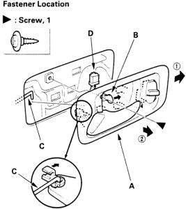

OK. I took off the door panel and unhooked everything on it. Then when I went to put it back on I connected everything back. While trying to put the latch back it kept fallin off. I just need someone to offer some advice on how to get the latch back on without it fallin off. Where is the latch supposed to connect to? I have to like rods that are in the same spot and I'm not even sure which one that it is supposed to hook to.

Okay I am going to give you the removal and installation procedures for your vehicle's door panel..
REMOVAL/INSTALLATION:
Remove the outside (side view) mirror.
If equipped with manual windows, remove the regulator handle by pulling the clip out with a small wire hook
Remove the screw from the door handle trim.
Slide the handle assembly forward and out to access the lock rod clip.
Release the clip
Disconnect the door lock switch
Remove the inner door handle assembly.
Carefully pry at the small opening on the bottom of the speaker grill.
Remove the speaker grille.
Remove the speaker mounting screws.
Detach the electrical connector and remove the speaker.
Remove the caps screws in the armrest (pull pocket panel), then remove the armrest.
Remove the center from the trim clip at the upper front of the door panel and remove the clip.
Using a suitable trim panel removal tool, unsnap the door panel from the door frame and detach any necessary electrical connectors.
Carefully lift the door panel up and away from the door frame.
Installation is the reverse of the removal procedure.
(((To remove the inner handle, pry the cap out (B) and remove the screw. Pull the handle forward and halfway out, then detach the rod (C) and power door lock connector (D) )))
