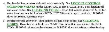

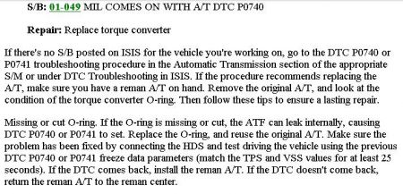

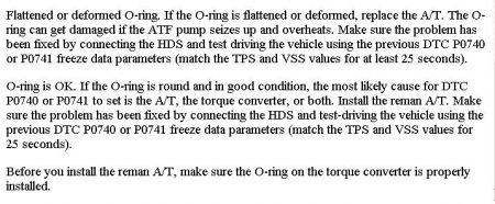

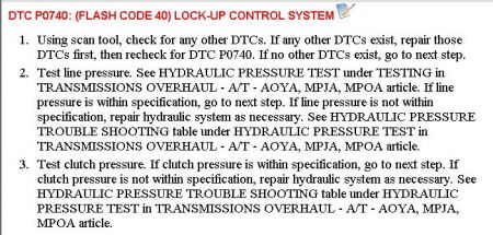

What I meant was that I need the code numbers to match with the Technical Service Bulletin. If I am to guess:
1. TCC dosen't Engage: P0741 Torque Converter Clutch Circuit Performance or Stuck Off
2. Open or Shut Circuit: P0742 Torque Converter Clutch Circuit Stock On
3. Electrical Connection: P0743 Torque Converter Clutch Circuit Electrical
4. TCC System 740: P0740 Torque Converter Clutch Circuit Malfunction
Anyway, here is the TSB for P0740 and P0741
https://www.2carpros.com/forum/automotive_pictures/55316_96accordp0740_3_1.jpg
https://www.2carpros.com/forum/automotive_pictures/55316_96accordp0740_4_1.jpg
This is from Honda ISIS computer
https://www.2carpros.com/forum/automotive_pictures/55316_96accordp0740_1_1.jpg
https://www.2carpros.com/forum/automotive_pictures/55316_96accordp0740_2_1.jpg
Thursday, January 22nd, 2009 AT 7:52 PM
