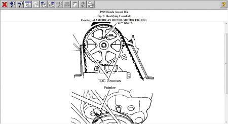

1995 Honda Accord 4 cyl Front Wheel Drive Automatic
which way does the nut on the crank pully come off and want are the timming marks
Thursday, February 12th, 2009 AT 3:01 AM
  • 75,992 POSTS
Turn it counterclockwise- as for the timing marks put the engine number one piston on its compression stroke then set the timing marks on the cam and crank sprockets.
https://www.2carpros.com/forum/automotive_pictures/12900_timing_marks_7.jpg
