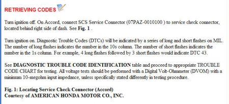

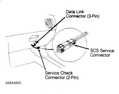

I HAVE A 1994 HONDA ACCORD EX IT CRANKS UP BUT IF U DRIVE IT AROUND FOR BOUT 10 MINUTES THE CHECK ENGINE LIGHT COMES ON AN IT CUTS OFF THEN IF U WAIT FOR A WHILE IT CRANKS BACK UP AN DOES THE SAME THING OVER AN OVER AGAIN
Wednesday, March 25th, 2009 AT 9:59 AM
OBXAUTOMEDIC
  • 3,711 POSTS
You will need to pull codes, below are instructions. Post code....
I will also email instructions for easier reading.
https://www.2carpros.com/forum/automotive_pictures/188069_94accordexretrievecodes_1.jpg
https://www.2carpros.com/forum/automotive_pictures/188069_94accordexservicecheckconnector_1.jpg
