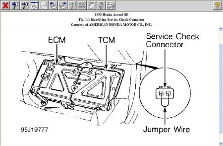

Hi Ricky,
When CEL shows, it would be easier to know what has gone wrong.
Retrieve the trouble code and see what comes up.
https://www.2carpros.com/forum/automotive_pictures/192750_SCS93Accord_11.jpg
Use a jumper wire to connect the SCS and turn ignition switch ON. Count the blinking of the CEL and let me know what you find.
Delay flashes = 10 counts and fast flash would be single digit.
Note pauses length. Long dely between flashes indicates next count.
