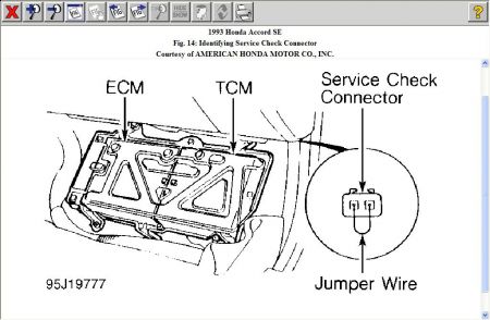

Here is the procedure for retrieving the CEL trouble code.
Connect the SCS with jumper wire (a paper clip bent to lug in would do) and turn ignition to ON. Count the flashing of the CEL , noting the length of the flash. A short pause is a continuation of long flashes. The code would cycle over once it has complete a cycle of codes.
https://www.2carpros.com/forum/automotive_pictures/192750_SCS93Accord_10.jpg
