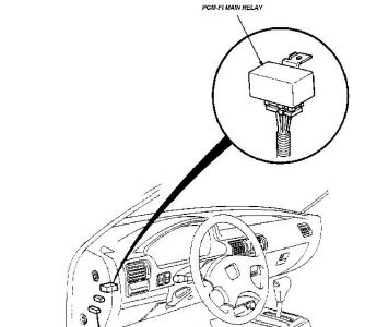

I need to know where the main fuel relay is located and how to change it
Monday, June 8th, 2009 AT 7:21 PM
KHLOW2008
MECHANIC
41,814 POSTS
Hi holic,
Removal is by detaching a bolt and unplugging the wire. If you are able to resolder the circuit board, it would be better than a replacement part.
