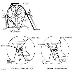

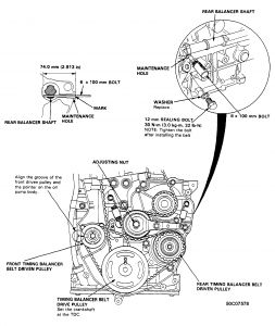

To rasmataz, timing belt broke. Need alignment marks for rear balancer/balance belt
Thursday, April 29th, 2010 AT 5:45 PM
MECHANIC
75,992 POSTS
See below
