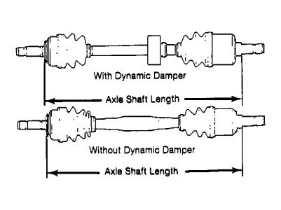

Check CV axles and its boots if ripped
if when turning making a clanking sound I would suspect a bad axle
and or upper strut mount
