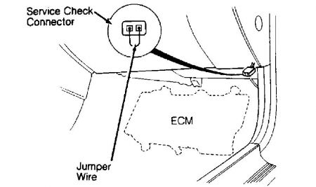

To retrieve the trouble codes, bridge the Service Check Connector and turn ignition switch to ON. Watch the Check Engine Light ( CEL ), it should blink.
https://images.2carpros.com/forum/automotive_pictures/192750_SCS91Accord_15.jpg
Count the blinks, a prolonged flash = 10 while a quick flash = 1. A short pause is a continuation of the code and a prolonged pause between flashes indicates a new code is about to be flashed. The cycle would repeat once all trouble codes are flashed. As to the dripping coolant, something is broken causing the leaking and you need to visually inspaect where it is coming from. How much would depend on what is causing the problem.
