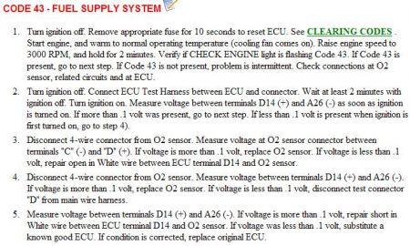

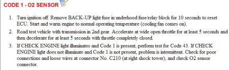

My car has the (S) light showing on the dash ,
So I hooked up the diagnostic connector for the
TCU and I get one long flash , Which I guess is code 1(?) Anyway . I've looked online and I cant find anything .
What Does Code 1 Mean ?

Most likely a faulty O2 sensor... Thanks for using 2CarPros.com!
