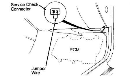

Hi xid003,
Since the S light is on, and the gears do not shift, you need to retrieve the DTC. If none found, the TCM is bad.
Connect the SCS and turn ignition switch to ON. Count the flashes on the S light, long delayed flash = 10 and short quick flash = 1.
https://www.2carpros.com/forum/automotive_pictures/192750_SCS91Accord_4.jpg
