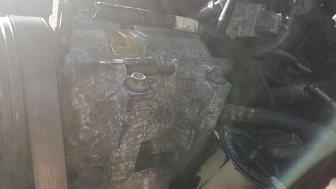

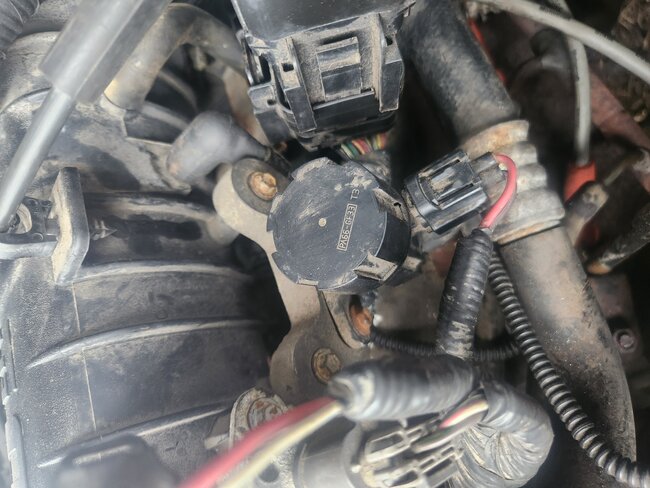

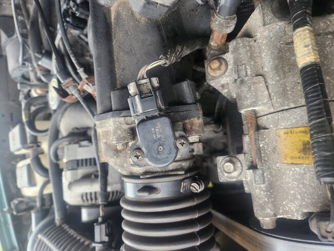

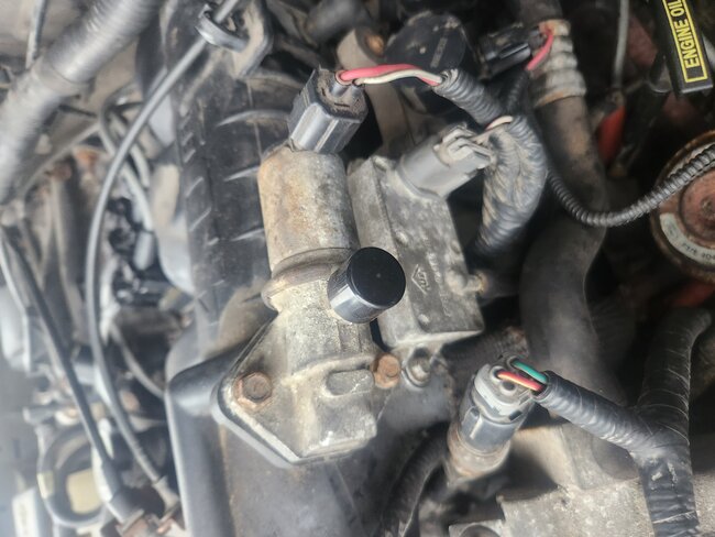

I replaced the driver side valve cover gasket. I had to remove the plenum to get it out. The EGR pipe that drops from the plenum to the EGR valve broke and I repaired it. I didn't replace the plenum gasket but didn't hear it leaking and spraying carb cleaner around base didn't change rpms. The problem now is it won't stay running without holding the accelerator down. The engine runs very rough at 1,100 RPMs, smooths out at 2,000. If you start the truck it revs to 2,000 RPMs and immediately shuts off. It doesn't seem like there's much fuel pressure at the rail, but I was unable to test it yet. Would a weak fuel pump cause this? Is it more likely a TPS, IAC, or one of the other components in the emissions circuit? How can I test the components in the photos and what else might cause this? I cannot find any obvious external vacuum leaks.

Sounds good, I would be interested in the live data percentage for the IAC.
Tuesday, December 12th, 2023 AT 11:53 AM
JEFF HERMAN
  • 486 POSTS
I don't think my scanner can get that specific or I don't know how to use it. If the IAC doesn't open on startup would this happen?

Update. The intake plenum seals leak a bit, I don't think the IAC is functional but the runs and idles smoothly when warm. The main vacuum leak was around the rubber grommet where the EGR pipe enters the intake plenum. It was not seated completely inside the plenum. It's difficult to do with a swollen grommet and the EGR valve attached to the manifold. There is an issue with oil accumulating in the air cleaner housing.

The video was before fixing the leak around the grommet. It runs fine for now but does need plenum seals and probably an IAC.
Sunday, December 17th, 2023 AT 7:15 AM
KEN L
  • MASTER CERTIFIED MECHANIC
  • 55,291 POSTS
Good call, a bad IAC can cause this as well. Let me know if you need any more help.
