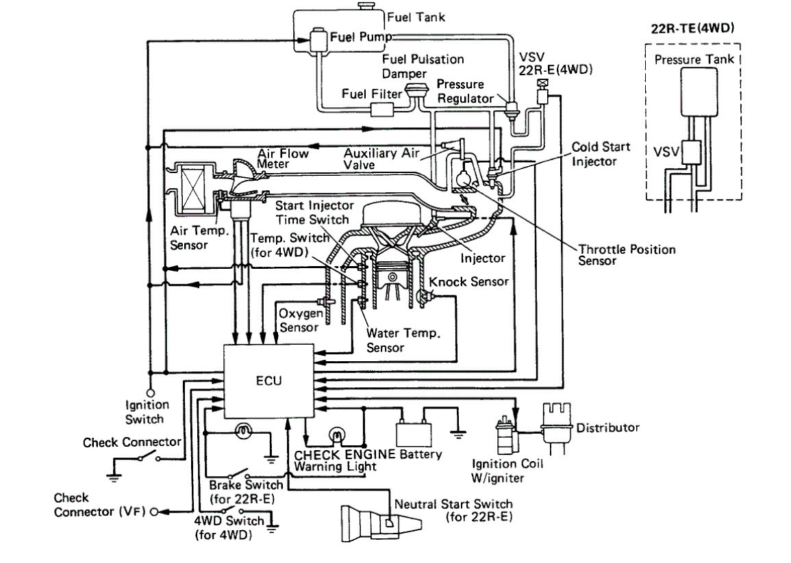

Choke/Vacuum lines diagram needed
SFCTRIPLETT57
  • 1987 TOYOTA PICKUP
  • 2.2L
  • 4 CYL
  • 4WD
  • MANUAL
  • 155,658 MILES

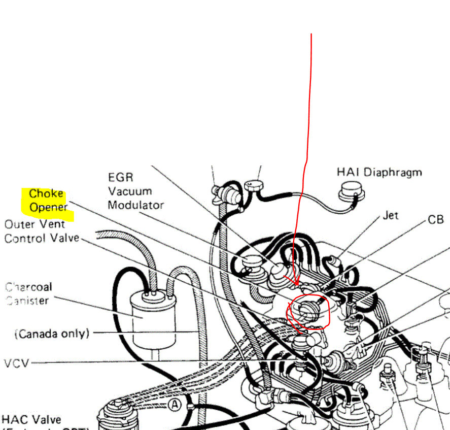

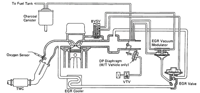

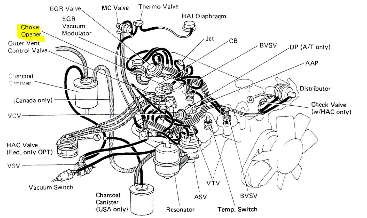

Good day Joe, how are you doing today? Great, I hope. Well, if you hold open the choke it does not flood. I can't hold the choke open, drive, and change gears at the same time. Well, I could like a cartoon show, the mechanic needs a diagram for the vacuum lines for the truck listed above. Can you tell from the VIN, JT4RN63R3G5012937? Can you tell me all the information on this truck?

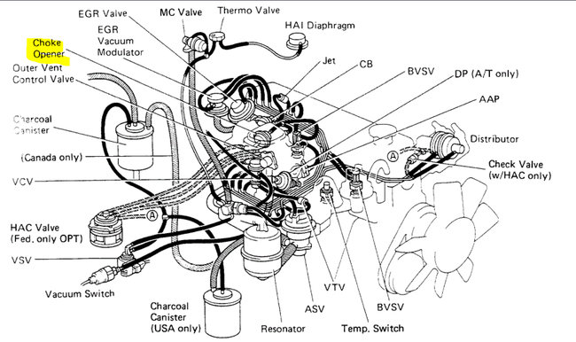

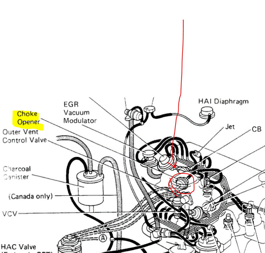

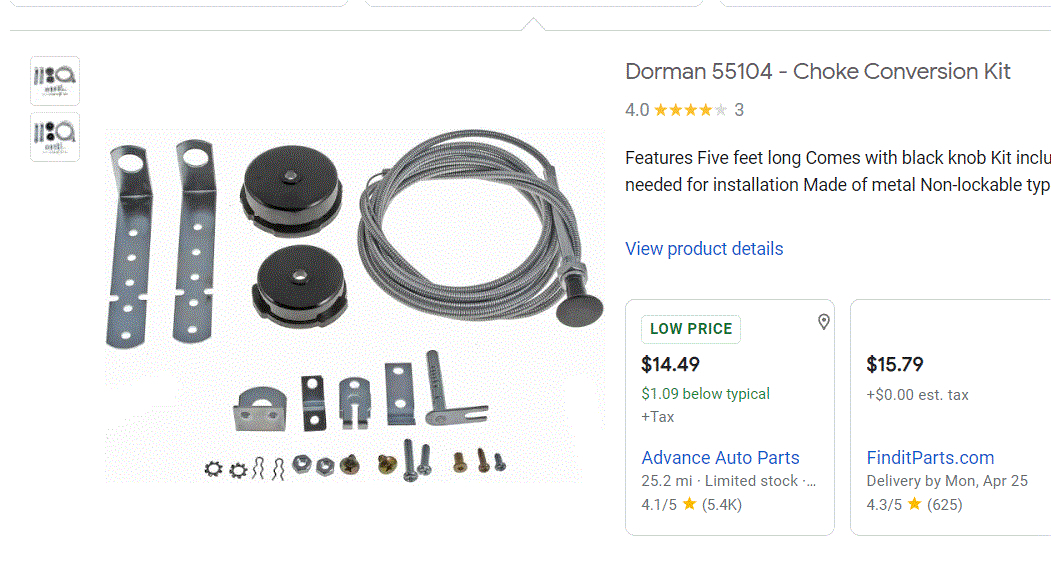

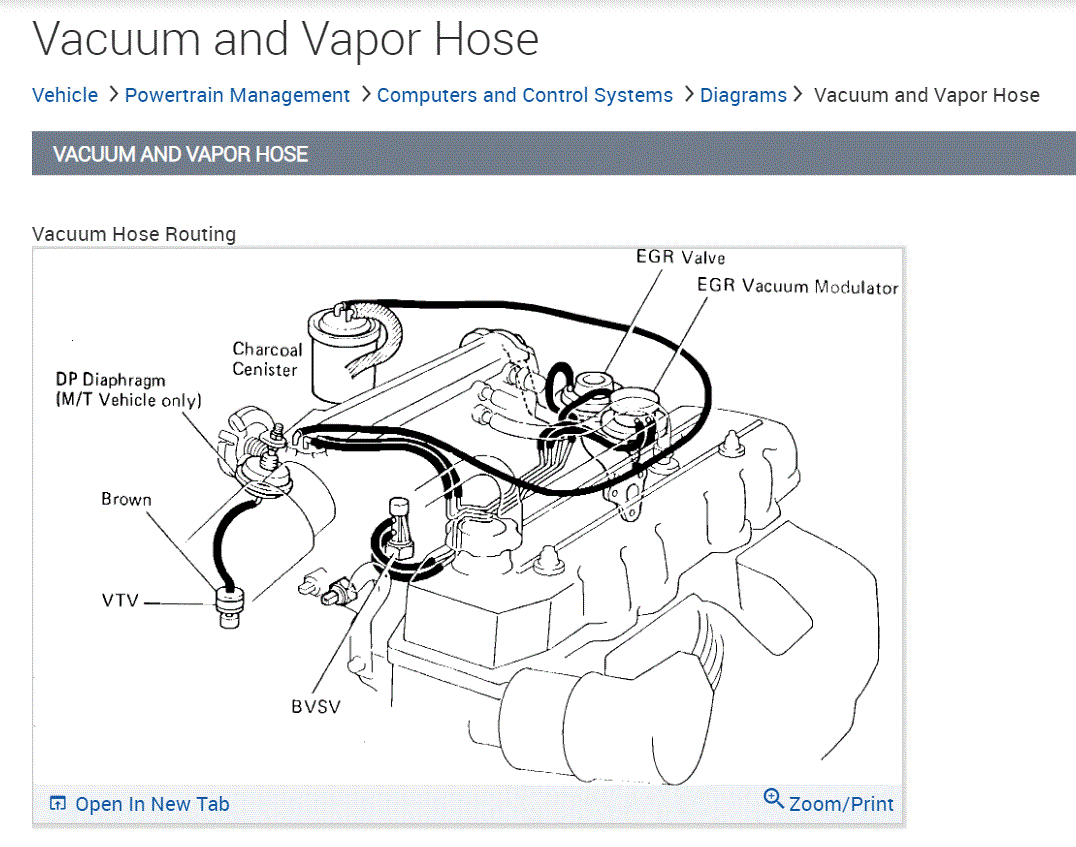

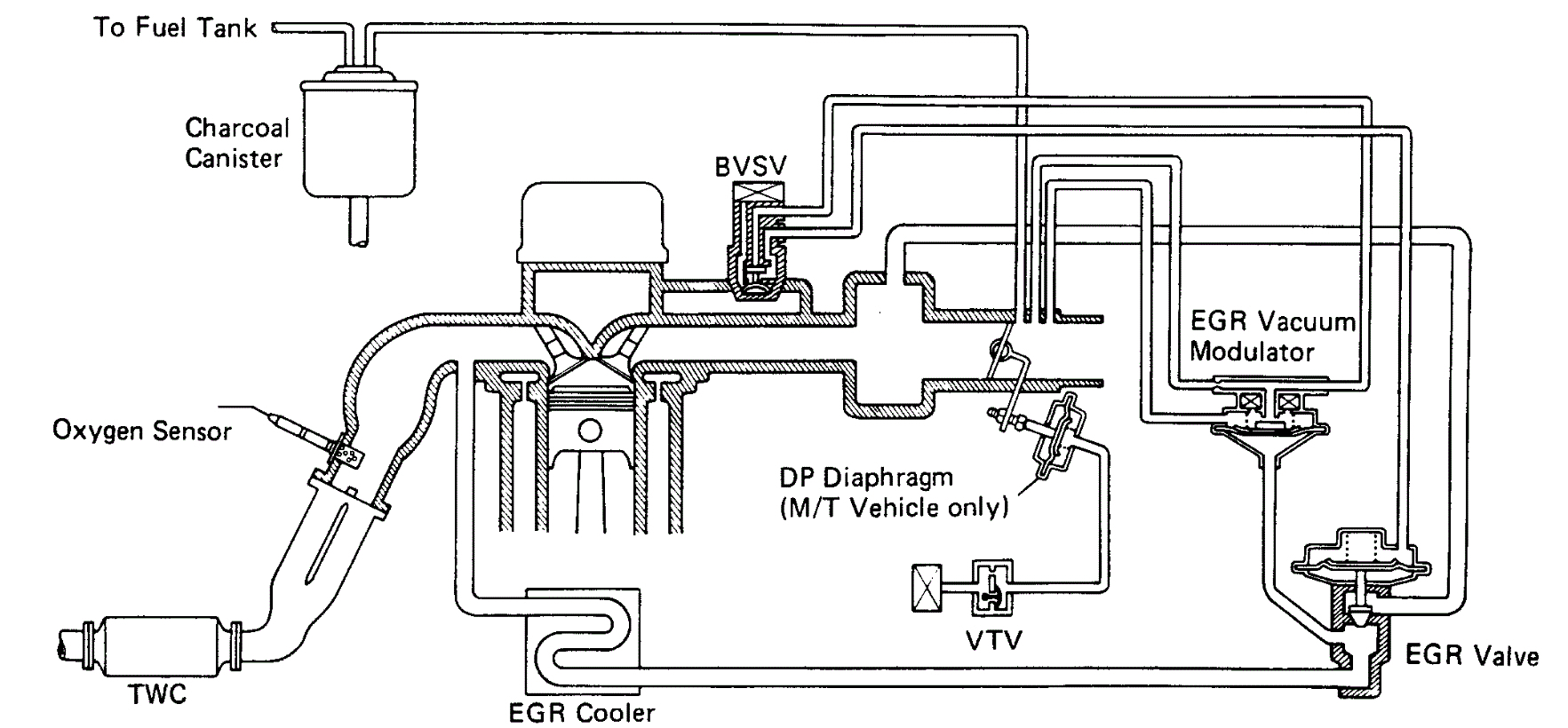

Thanks for the image of you driving and doing everything at once. I got a laugh out of it. As far as the vacuum diagrams are concerned, I attached what I have, but nothing for the carburetor. Is there a vacuum break that actuates the choke to open? If there is, it should have a vacuum at all times. Send me a few pics. Also, if we are unable to get it working, you could install a manual choke cable so you can use it from in the truck. LOL
I attached the schematics I have below. Take a look.
Let me know if this helps.
Note: Take a look at the last pic first. That is for the 22R engine. Let me know if that one helps. It makes more sense.

As far as the vacuum break, I attached a pic below showing it. Basically, it only allows the vacuum to travel in one direction.
The manual choke kits are inexpensive and usually give you about 50% more length than is needed. I attached a pic below of an example.

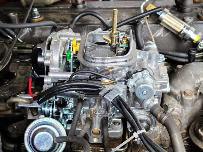

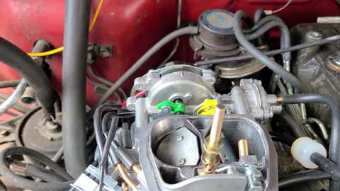

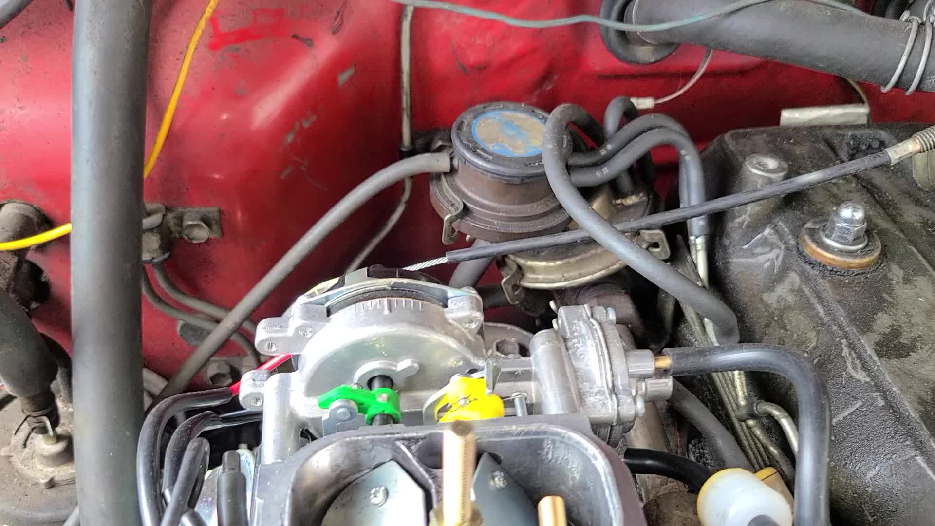

How are you today, I got a choke cable to put on the truck. I dropped off the diagrams at the guy's house that is working on the truck. The truck started fairly good; the first video is the truck running from a cold start. I can still smell gas when it's running it runs better and starting better than it did.

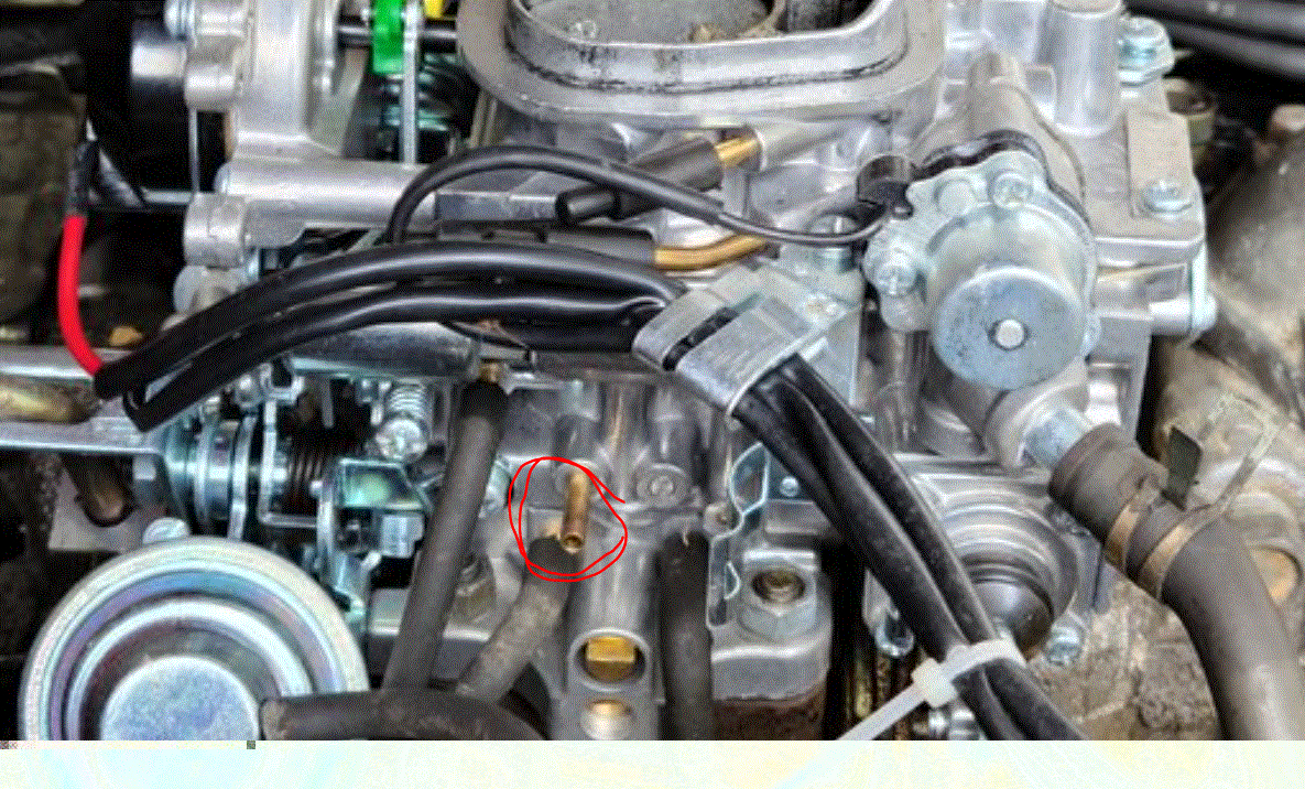

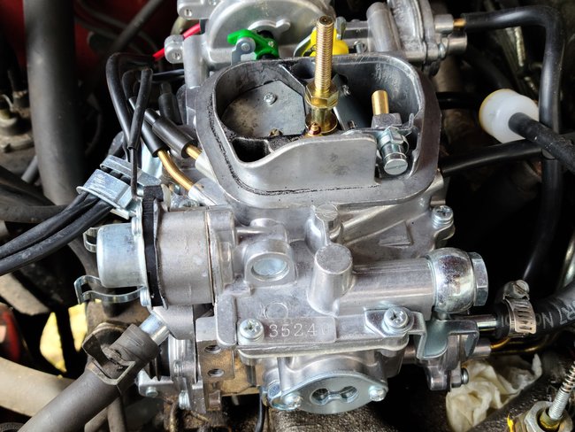

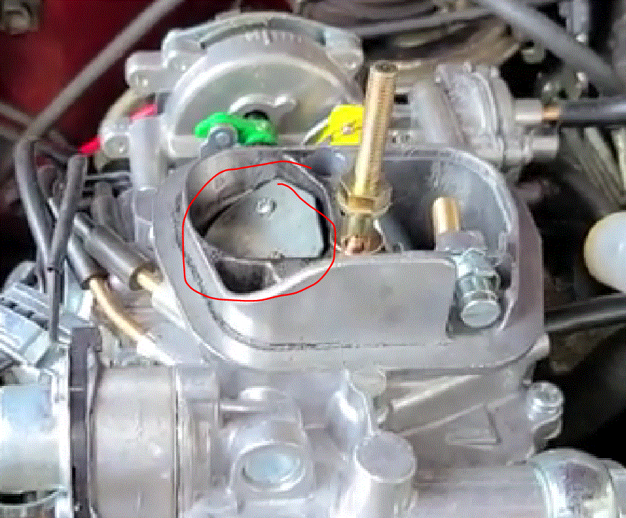

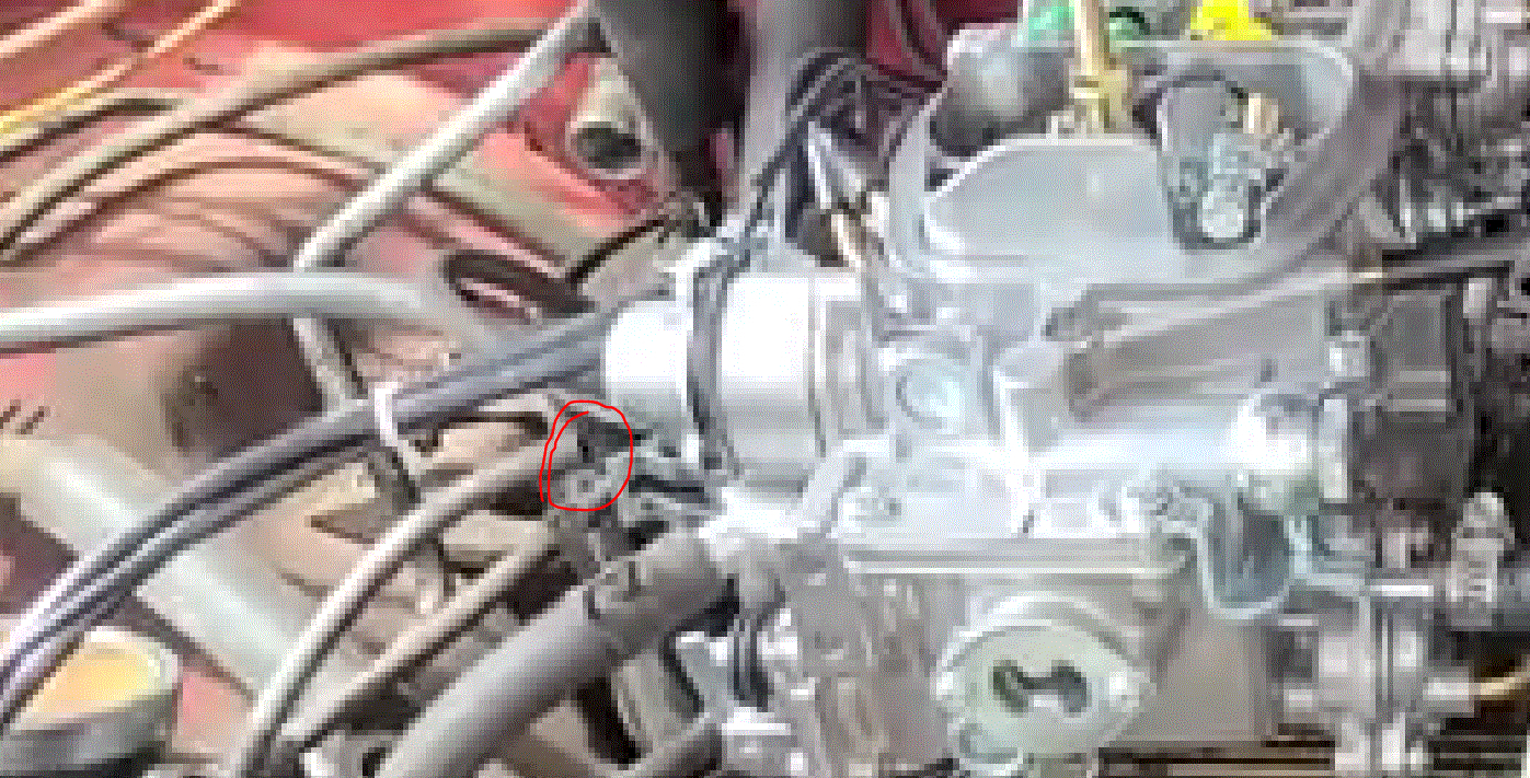

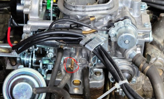

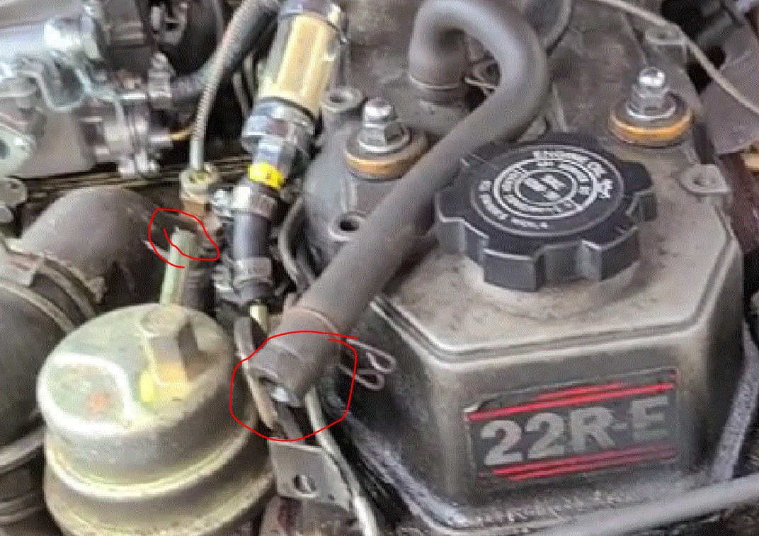

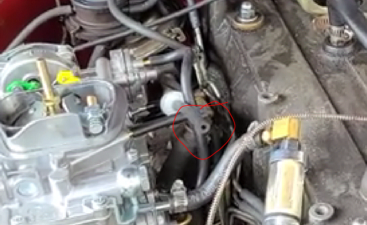

Also, I watched the video. There are several open vacuum hoses/ports that are contributing to how rough it is running. I attached pics below. Note: There is an open port at the base of the carburetor that certainly needs to be plugged. Take a look through the pics and let me know your thoughts.
Next, I attached a pic of the choke. It should be open further if the temp was warm. Otherwise, it is going to draw too much fuel.
Let me know what you find. Also, I hope everything works out well for you. Take care of yourself.

Thank you for the diagrams, Mike said they are helping him a lot. We found two sensors that have broken hose contactor, we can't the vacuum lines on. He was supposed to let me know what they are. He spoke to me and told me they control the timing, distributor, and some other things. Thanks for all your help you have given me.

No problem whatsoever. I'm glad they are helping. I noticed a few hoses disconnected in your video, that's why I attached the pics.

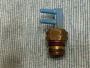

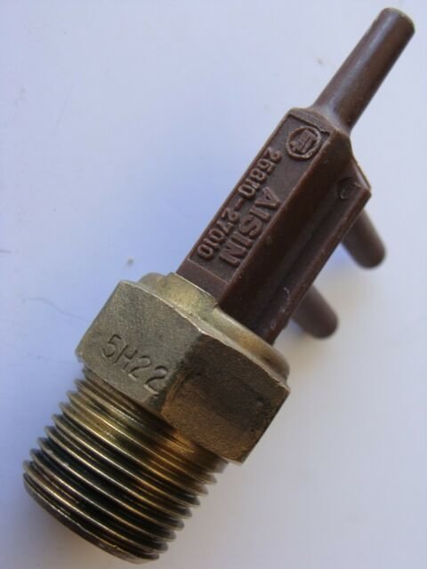

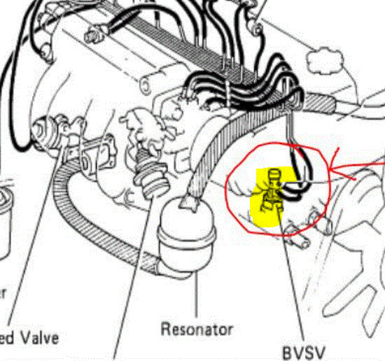

Hope all is well with you and your family; we had a good day here too. Okay, my friend Mike that's working on my truck has found two BVSV sensors that are damaged with broken contactors. I don't know what they look like or where they are on the truck so I can order them, I have access to the old Toyota 87 engine. I have access to an old 1993 Toyota truck; I wonder if I can use the BVSV valves off them.
I think this is what the BVSV valves look like, I may be wrong. I can't work on my truck; I can hardly lift my coffee cup my wife has to open things for me. I can't even go turkey hunting I can't pull the trigger' I could adjust the trigger from 6-pound pull to less than 1-pound. If I do that the rifle would be too dangerous to use. That would make it with a hair trigger.

Regardless, I would remove the parts from the other parts and see if they have the same part numbers, or at least we can try to determine if there is a difference.
The valve is what controls the vacuum to the EGR and prevents a vacuum supply when the engine is cold. So, it is a somewhat important valve.
The old one should work. However, let me know what part number is on it.

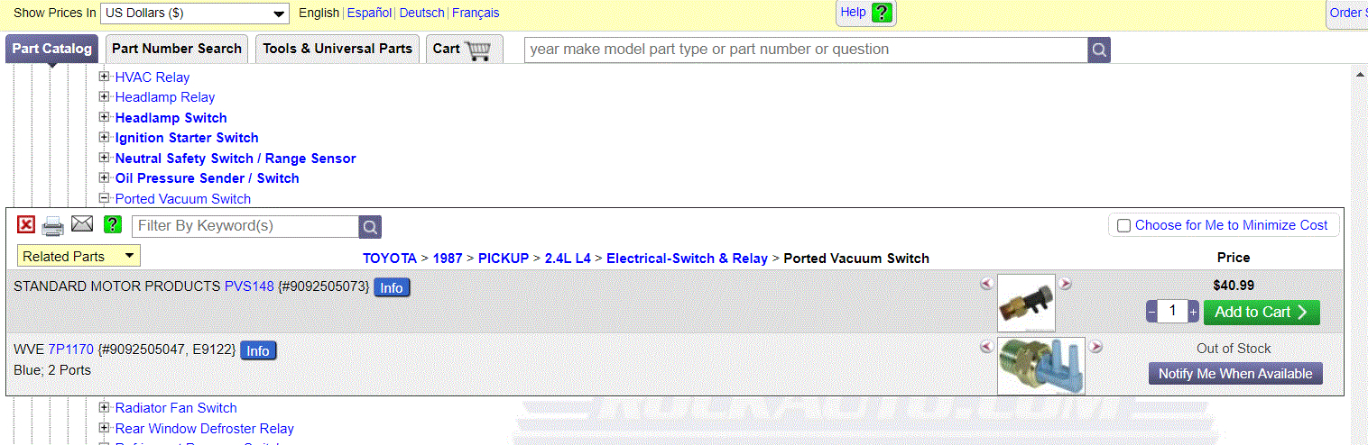

Joe, I really don't know what I am looking for, I need your help.
Wednesday, April 20th, 2022 AT 2:48 AM
  • 110,194 POSTS
No problem. I attached a pic below from rock auto. Check around and see if you can find one for less.
If you are trying to locate it on the engine, it will be at the front of the engine. See pic 2.
