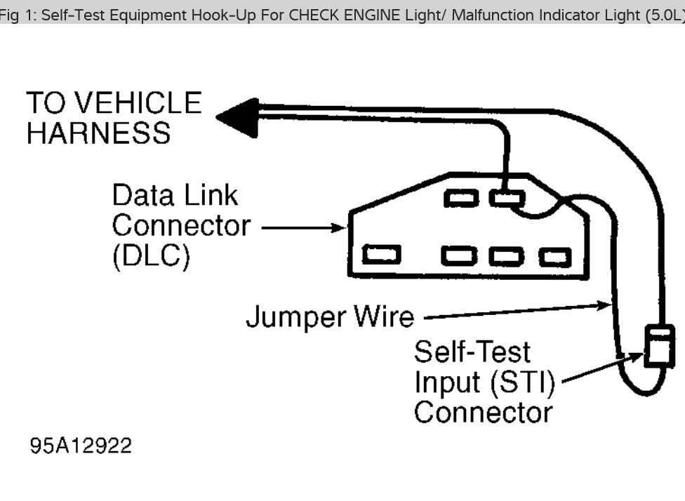

It has got quite a bit of dirt caked on the exhaust so I have not yet and I did not get a chance to work on it today either like I thought I would. I checked all grommets and seems to be fine, and I sprayed carburetor cleaner around intake, all vacuum hoses and plugs with no luck. Just trying to make sure I know everything I can check before I go back and work on it. It is two hours from my home. Do you know any tricks to using the Innova obd1 scanner? It works on my 1992 F-150, but I plug it in to this truck and nothing. Tried following the instructions in the scanner book to jump ground to initiate self test and still nothing. I have around 2.7 vdc at the two bottom center pins of the eec test port and ground at the individual wire.

Jump with a wire and key on for check engine light to flash get back with codes yours is still under hood. See pictures.

Yeah, that is obd 1 and I tried that.

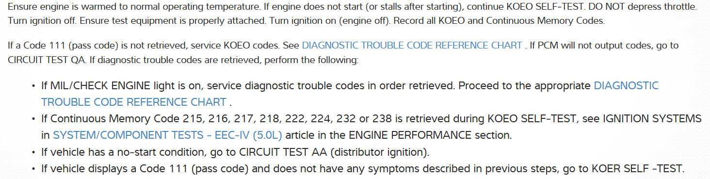

Did you get any codes? here is a guide to help also.
