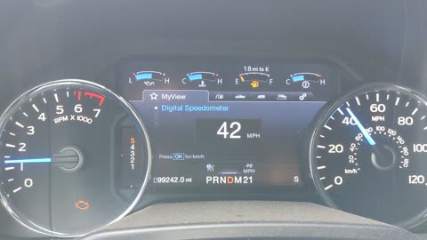

Can you please shoot a quick video with your phone so we can hear the noise? that would be great. You can upload it here with your response.
Jun 28, 2021 at 12:28 PM

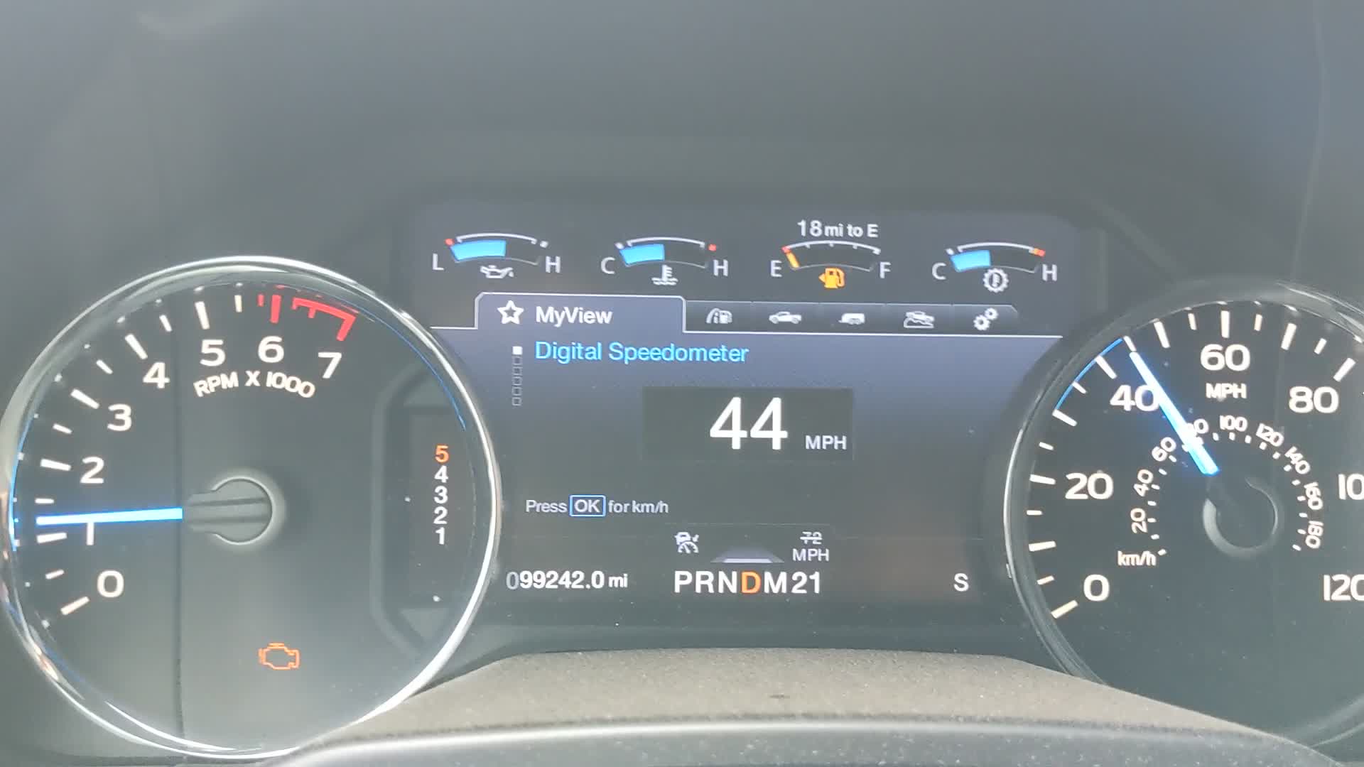

SHOOTER88
Here ya go.
Jun 28, 2021 at 1:38 PM

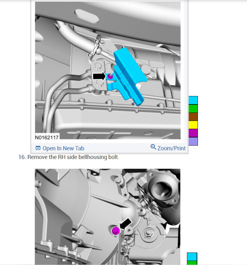

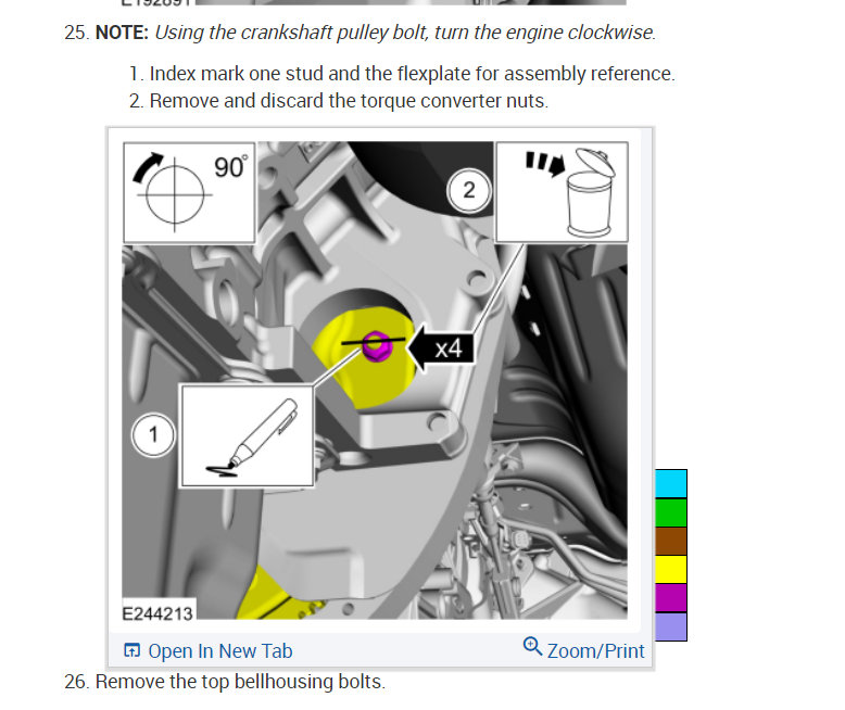

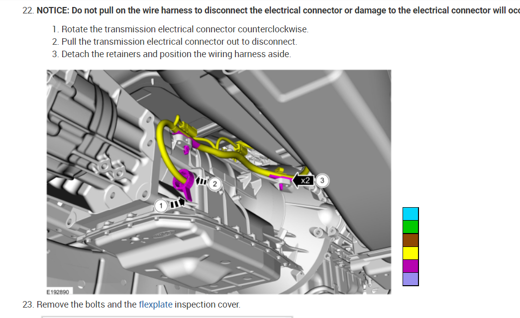

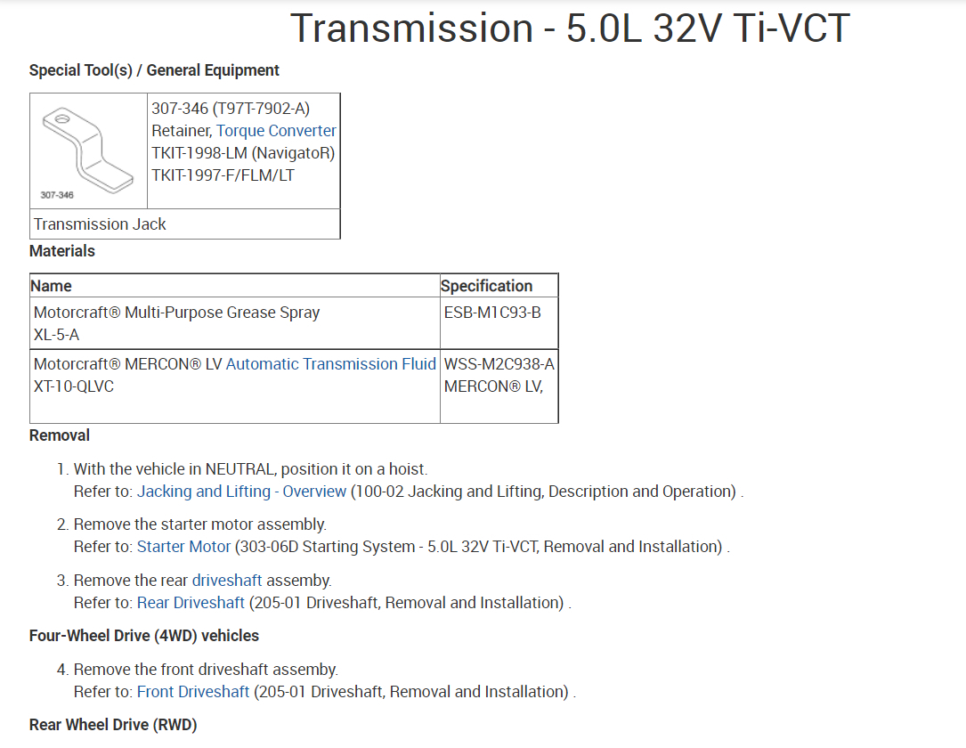

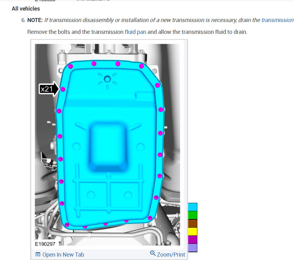

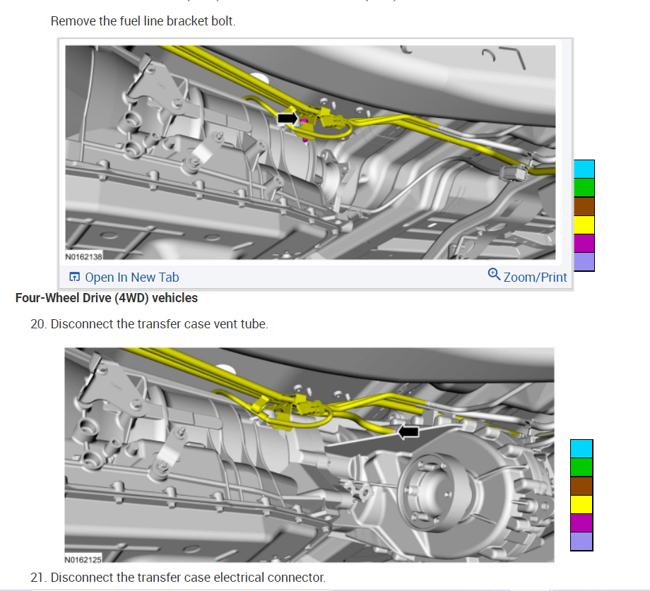

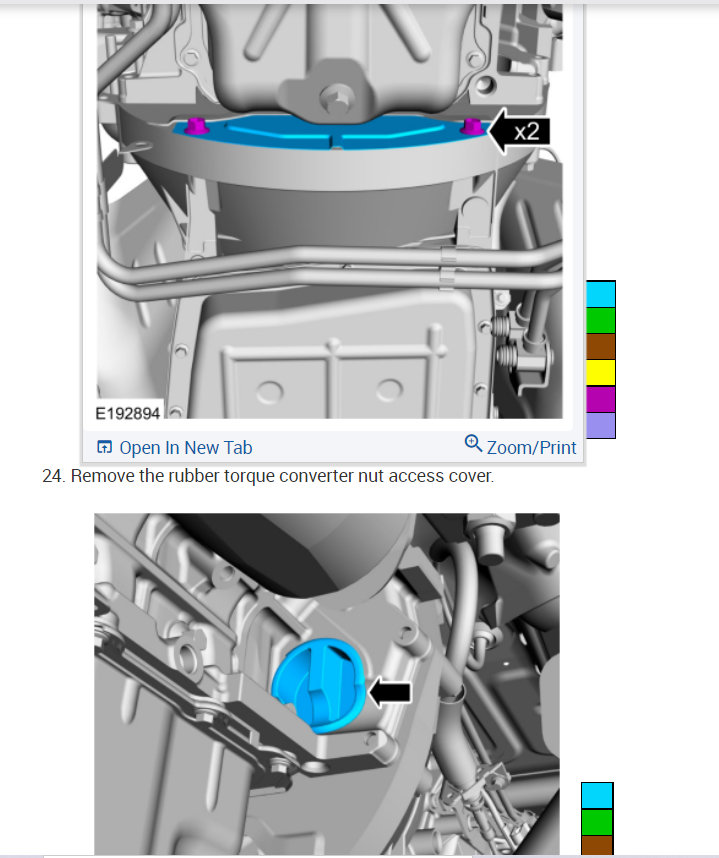

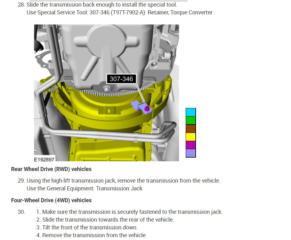

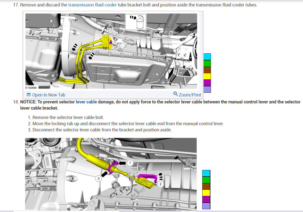

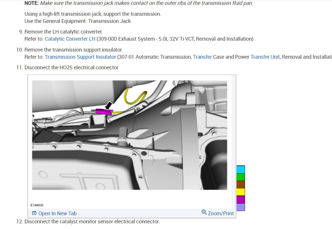

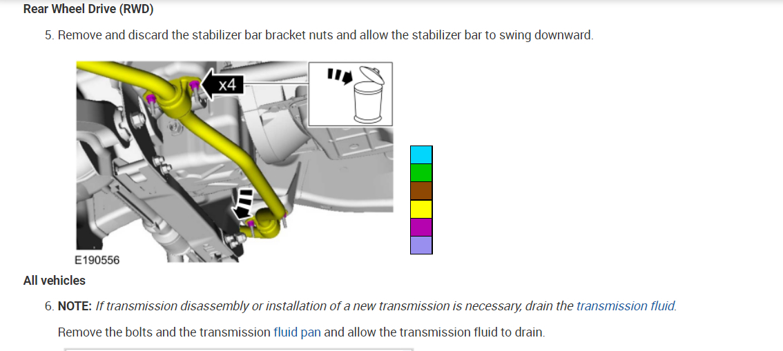

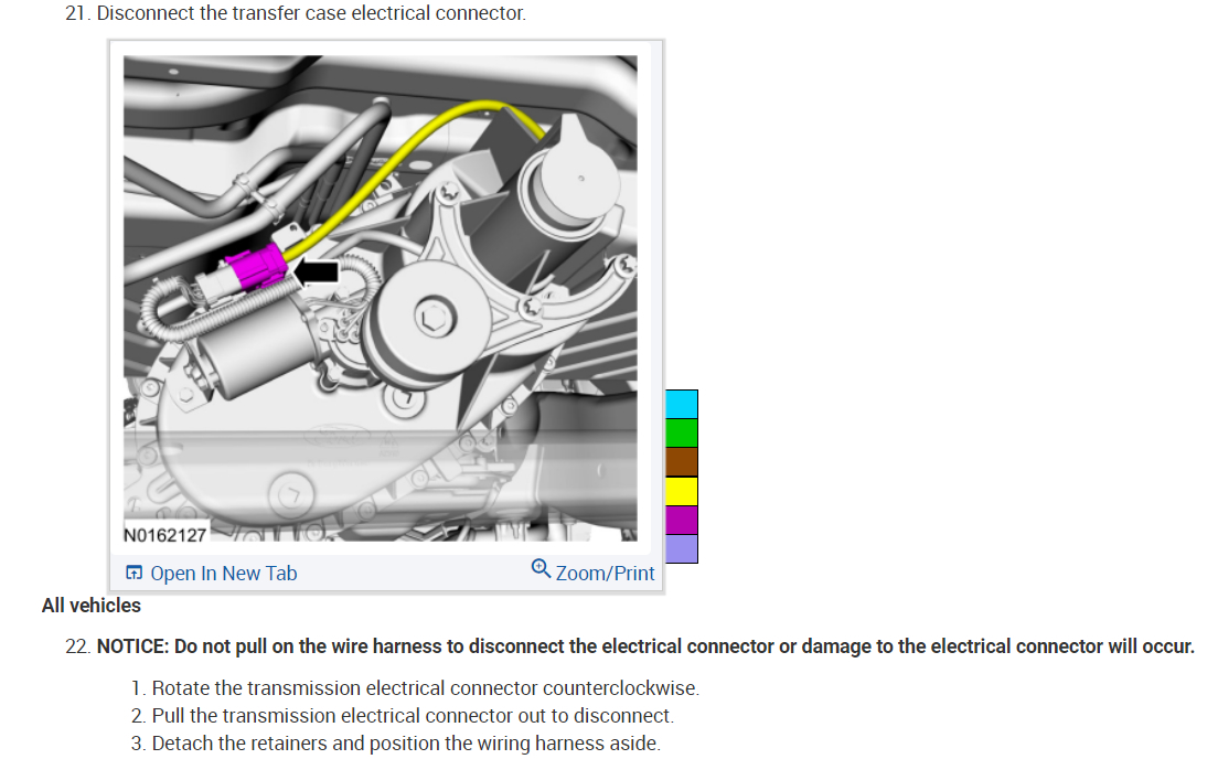

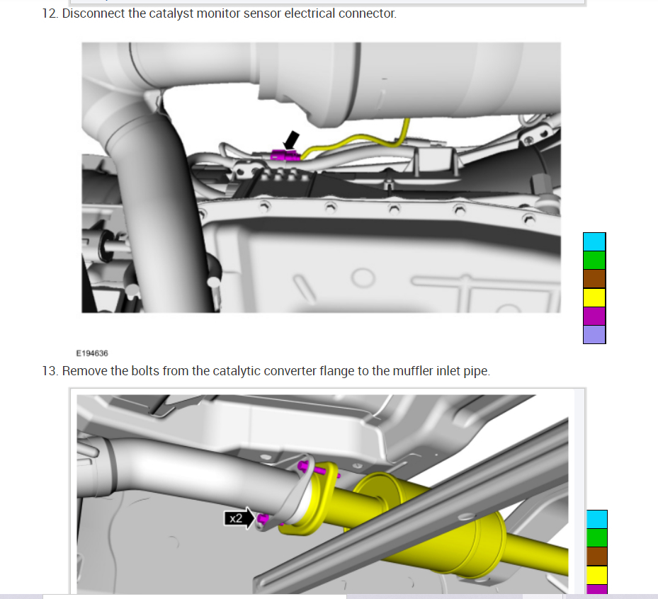

That noise sounds like the torque converter itself. I would have it confirmed by someone. There may be debris in the converter from the original replacement.

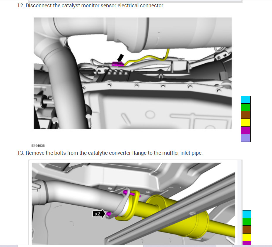

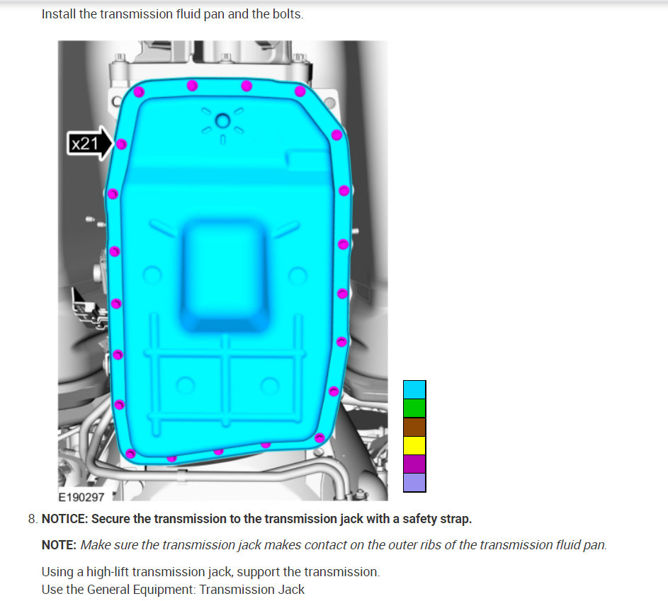

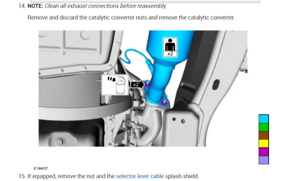

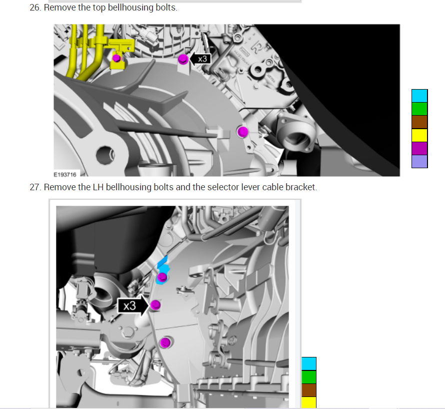

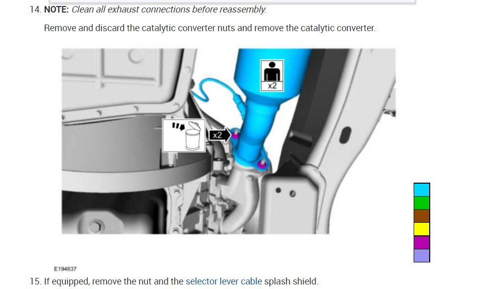

Roy I attached below the procedure for replacing the converter itself.
Let us know if you have any other questions.
