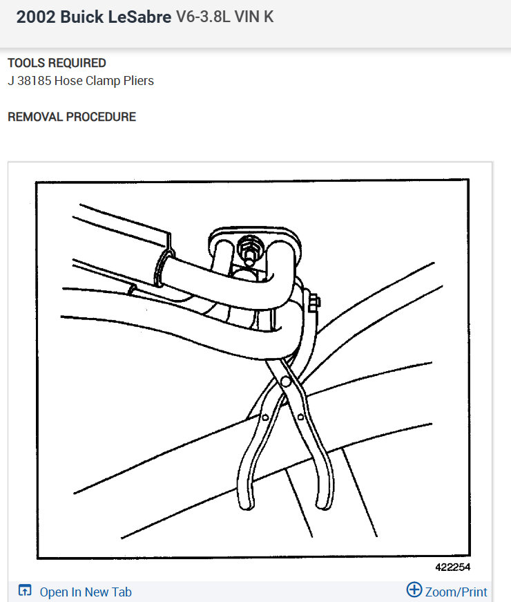

If the engine is not overheating the water pump is okay, to me it sounds like the heater core needs to be flushed. I would remove the heater hoses and use a garden hose to help flush the core. Check out the images (below). Please let us know what happens.

You too. I was thinking it could be the heater core itself but theres no fogging inside the car. No leaks inside on the floor. No coolant lost anywhere so. I'll find out ! Later

Yep, it can be just clogged internally which is common.

Merry Xmas Ken! I couldn't get those hose clamps off and it was getting colder because I was doing things outside, so I didn't want my hose to freeze up or break, so I gave up. I'm going to have a shop do it for $60 and be done with it. Thank you. Have a Happy New year and if I ever need your help, I'll be sure to reach out. Later on.

Hi Ken, Got the heater core flushed. It took them 3 times plus they had to replace my right actuator, so I now have heat! Better than I ever had! Take care Ken. Thanks for your advice. You're on my speed dial. Later on.
