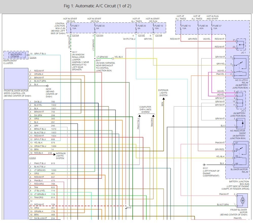

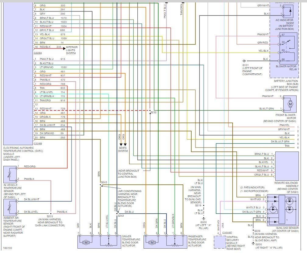

KEN L
  • MASTER CERTIFIED MECHANIC
  • 55,266 POSTS
Hey JGAULIEN,
There is a blower motor speed controller that has probably gone out, here is a wiring diagram and guide so you can do some testing.
and
Please run some tests and get back to us so we can continue helping you.
Best, Ken

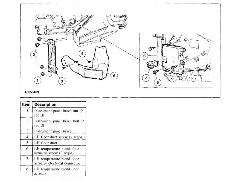

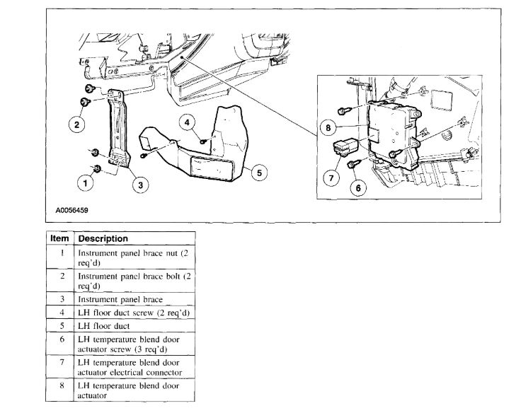

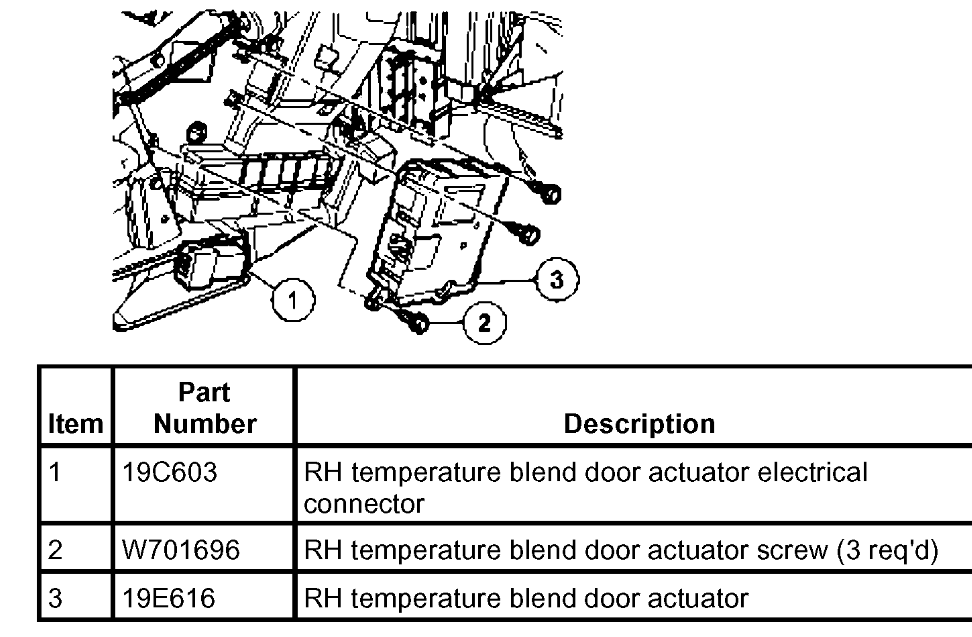

Good afternoon.
That is the blend door actuator and the reason you have no heat. You need to replace the blend door actuator.
The procedure is below with pictures.
REMOVAL
1. Remove the floor console.
2. Remove the steering column opening cover.
ImageOpen In New TabZoom/Print
3. Remove the components in the order indicated in the illustration and table.
INSTALLATION
1. To install, reverse the removal procedure.
+1

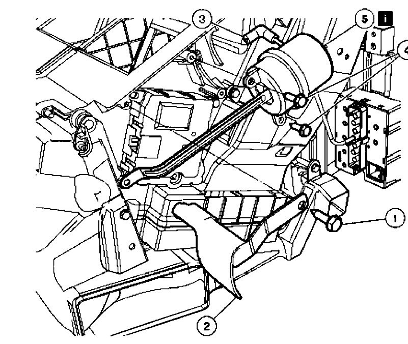

HMAC300
  • 48,601 POSTS
Check for a vacuum leak at heater. It may be at control or at vacuum motor or a bad vacuum motor. See picture. If the motor has to be removed the dash has to come out.
