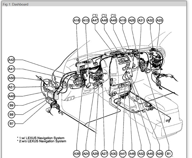

I am hearing a high pitch whine from beneath the glove box when the heater blower is turned on. The sound is not heard when on highest speed (probably because the fan is making too much noise).
I just replaced the motor/blower thinking it was a bearing going bad, but it did not help. The sound almost reminds me of the whine from a car stereo amp that is poorly grounded.
Any thoughts on what the problem is?

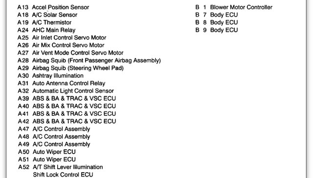

This sounds like a blower motor speed controller that is going out. Here is the location so you can check it out.

I had this problem with my car and the controller fixed it. thanks for the diagram. :)
