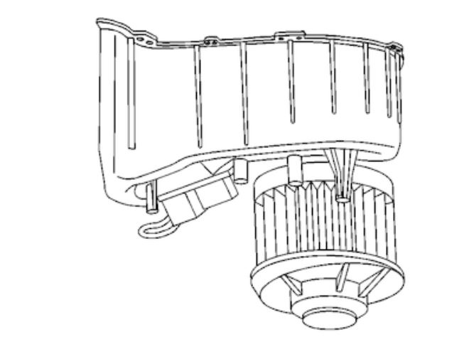

The blower when on it is intermittent, goes fast and then slows down. I changed the resisters but the problem remains.

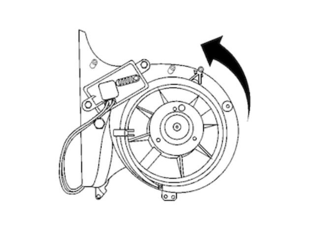

I posted the procedure below and attached some pictures for you for the replacement.
Removal Procedure
If equipped, remove the sound insulator panel. Refer to Instrument Panel Insulator Replacement.
Remove the blower motor insulating cover screws.
Disconnect the electrical connector from the blower motor.
Remove the blower motor insulating cover.
Pull the retaining tab down while turning the blower motor counterclockwise in order to disengage the blower motor from the heater/ventilation module.

If you replaced the resistor, then the motor sounds like it is locking up or seizing while it is running.
Saturday, December 28th, 2019 AT 11:37 AM
SOTOSON
Thank you, that took care of the problem. I appreciate you help.
