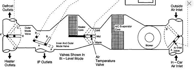

I have changed the blower motor and switches the blower motor works fine, but for some reason even on high the air barely flows out of the vents, no matter where I put the blend doors (I have even unhooked and operated them manually just to check) it has no change. I have checked the duct work as best i can and have not found any clogs. I am totally stumped. Please help

No just the motor, looking at the diagram it looks like the vent motor is by the driver? It have two actuators turning different doors right next to the passenger feet, no matter where they are set the heat still just barely blows.

Ok back at this lumina sir, i have checked fluid level n bled the coolant system, the new blower motor came with a new cage on it, still no matter what i do with the actuator doors it only blows thru the vent and very little when it does even with the blower on high, i cant see how to get inside the ductworking without taking the whole dash out of the car ( i really dont want to do this) im pullin my hair out on this

You will need to look at the ductwork for any obstructions that will cause low air flow.
Since it is at all modes, it sounds like it is back at the blower motor.
I would start at the blower motor and remove it and look around and see if you see or feel anything that is causing the obstruction or leak.

Okay, i was elbow deep in the box from where the blower mounts, all i can feel is open box and a couple messed up springs, i can't find what they go too no doors etc.,

Okay, then you may have an issue right at the blower.

New, i powered it up outside the box and it blows lots of air. could it have not been sealed correctly? It had a little air leak around a small part of the seal but i couldn't tighten the screws anymore without stripping the plastic.
Mar 3, 2019 at 10:38 AM
  • CAR REPAIR CONTRIBUTOR
Yes. You can use some sealer such as RTV.
Listen for any other leaks in the duct work as well.

Okay, it is now a life mystery with no answer lol. no leaks no obstructions good thing the weather is warming up.
