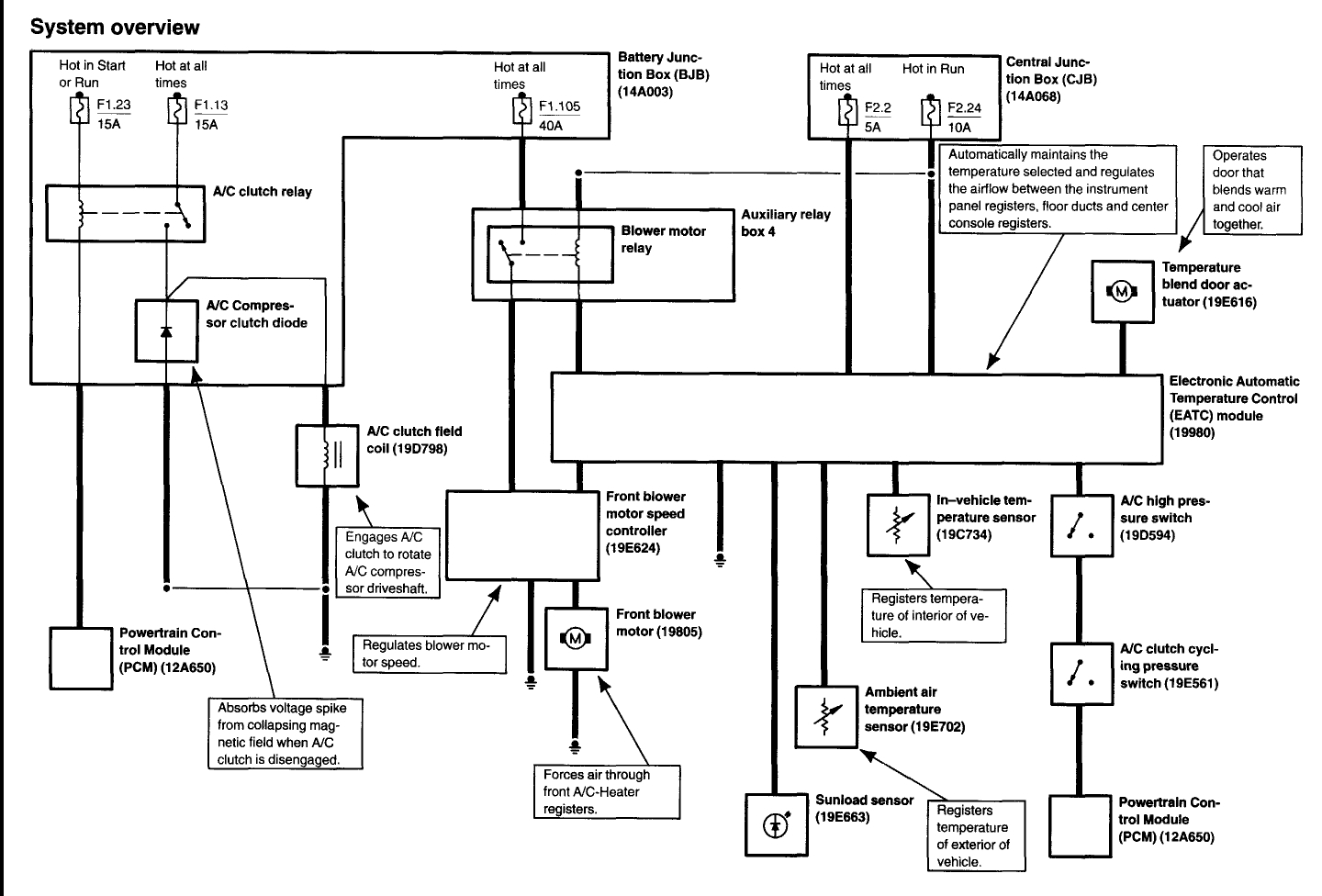

The fan speed had been fluctuating for quite some time, seemingly with engine rpm. Most often when at low rpm. Today, after stopping, the blower motor will not operate at all when I restarted the engine. The fuse in the underhood box is good. I have the auto climate control, which has only operated on defrost for quite some time.

There are multiple fuses and relays in that system. Go through all of them and make sure they are not blown. If the fuses are all good when tested then it is likely that the control head has failed. The issue then becomes which option package you have as to getting the correct control head or having yours repaired.

I checked all of the fuses and relays first. Since asking the question, I went ahead and tested the voltage being supplied to the blower motor control module which tested at 12.1V. This told me that at least one of my problems was there, as a max of 8.3v was being supplied the blower motor when the fan speed was on high. Replacing the module fixed the problem. I did also source a used HVAC control head to hopefully fix the other issues with the system, I have not installed it yet. A note for this job is the module for the auto climate control will cost $175.00 to $250.00. You will wish you had the control knobs! You also will need to be proficient at using a multi-meter to test to narrow down the possibilities. The only info I could get for the tests was very technical written test procedures from the Ford dealership system.
