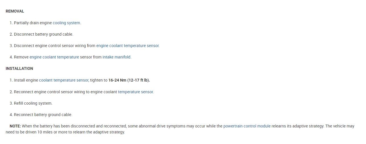

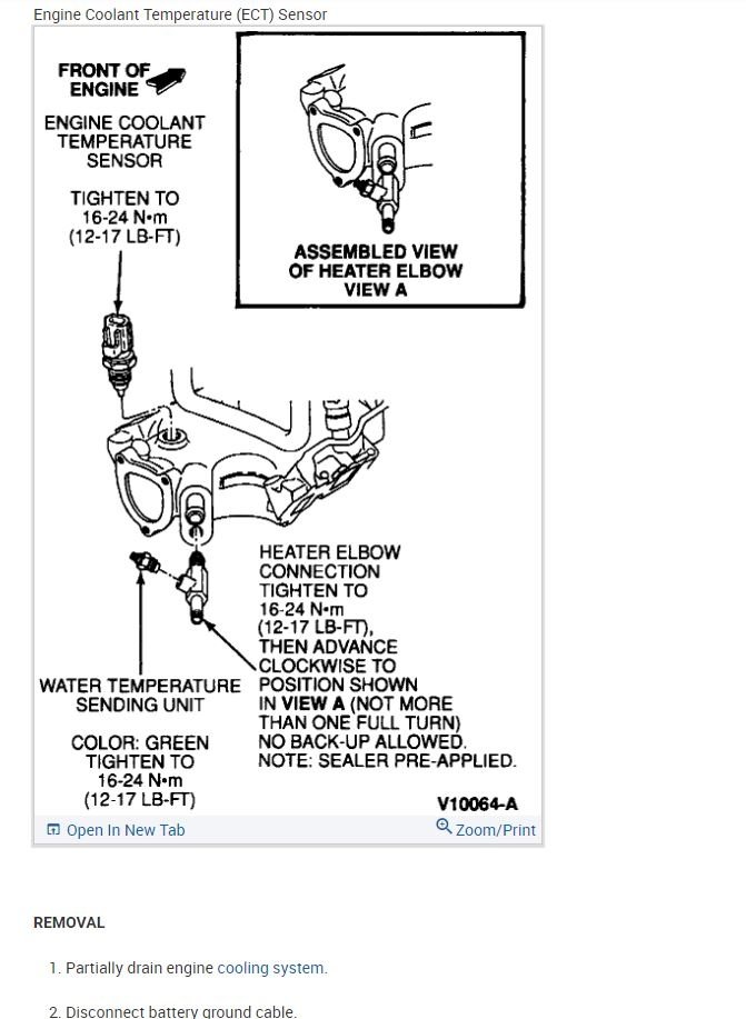

Where is it located on the engine exactly?
Sunday, April 4th, 2021 AT 1:11 AM
MECHANIC
52,796 POSTS
Good morning,
I attached pictures and the procedure for you of the sensor below.
https://www.2carpros.com/articles/coolant-temperature-sensor-cts-replacement
Check out the diagrams (Below). Please let us know if you need anything else to get the problem fixed. Roy
