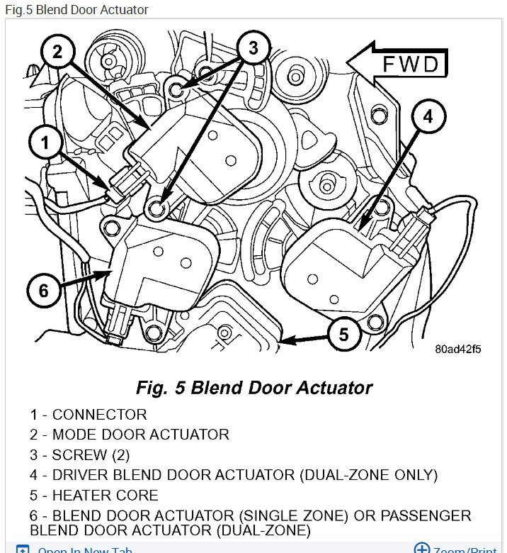

The 2-3 second delay in the compressor coming on is normal, I would make sure the system is full of refrigerant, this can make the compressor kick on and off, this video can help:
https://www.youtube.com/watch?v=uZrQCGwXfek
Also, it sounds like the blend door actuator is weak, here is the location so you can swap it out with the new unit. Check out the images (below). Please let us know what happens.
