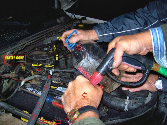

The heater is not working in my truck. I have replaced the thermostat, the hoses to and from the heater core are both hot. So I believe the heater core is working, and the coolant level is good. The blower fan works (only on highest setting) but still cold air only. Any thoughts?
I appreciate it.

Are the heater hoses so warm/ hot that it is hard/ impossible to hang on to either?
If this just is not happening, maybe your heater core is stopped up (not allowing hot coolant flow through it)
If you will leave the heater core in place (where it is nearly impossible to get to)
leave its hoses connected to it.
Take its heater hoses loose out at the engine.
Now you have two hoses with a little flexibility that are connected to the heater core.
You are not crammed against the firewall with no room to flush.
Back flush time!
I like to "blast" into one hose and then "catch" in a vessel from the other
(then switch hoses-blast in the other, catch in the other)
It may take a few "musical hoses" trips to backwash the core.
The "catching" allows me to maybe see what the heck was stopping up the core. Normally chunks of rust or a massive amount of that "stop leak" glitter looking material.
This method will not work if there is some sort of control valve that is closed in one of the hoses. (In itself, it could be the reason for 'no flow' through the core.)
I made a picture the last time we flushed one, it is not a good picture, you may see the process as we flushed just one direction, before we switched to go the other direction.
Keep us posted
The Medic

Go easy on hose pressure at first, usually a reverse flush is customary. I have done this method with a solution of muriatic acid followed by a quick flush with water, Great results on a 1992 Lincoln Town car.
