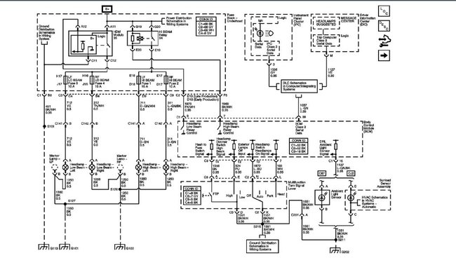

Both pass headlights went out simultaneously
2006 PONTIAC GRAND PRIX
160,000 MILES • 3.8L • V6 • 2WD • AUTOMATIC
JEFF BANKER
Relays are good, fuses are good, bulbs brand new, parking lights all work as do both drivers side headlights.

Good morning,

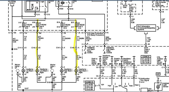

There are separate fuses for the headlights on the right side. You need to verify power at the fuse on both sides and then verify power to the connector.
Let us start there.
I attached the wire diagram for the lights below.
