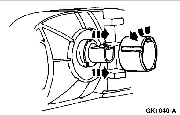

How do I change the headlights
Aug 31, 2025 at 8:10 AM
  • 54,494 POSTS
It is pretty straight forward, just disconnect the wiring from the bulb and remove the retainer ring. Check out the images (below). Let us know how it goes

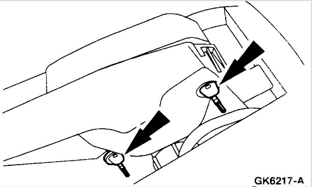

Gotcha, here is how to change out the headlight lens. You will need to remove the upper plastic above the lenses. Here are the fasteners you need to remove. Check out the images (below). Let us know how it goes

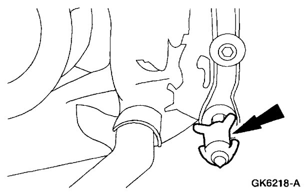

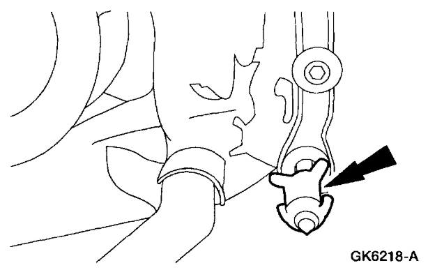

SMCJACKSON
How do you remove the fasteners?
Sep 4, 2025 at 11:40 AM
  • 54,494 POSTS
Use a 14 mm quarter-drive, deep well socket to release the headlamp assembly retaining clip. Check out the images (below). Let us know if you need anything else.
