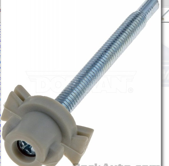

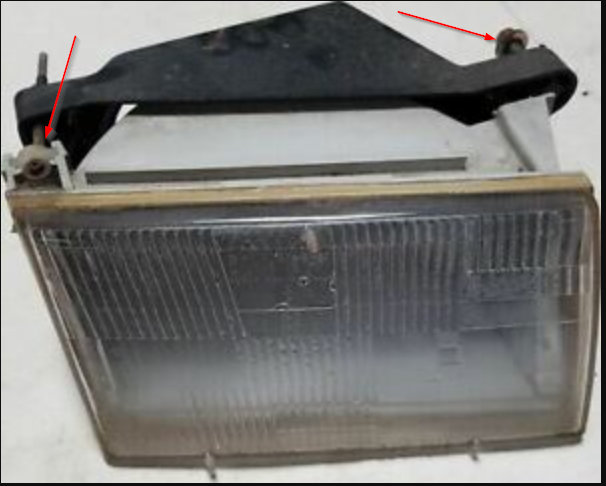

Where are the headlight adjustment screws located on my car listed above? Where can I find a diagram?

They are going to be in the upper corners depending on which side you are looking at. Take a look at these pictures that will give more detail.
Here is a video on how to adjust these. Clearly your adjuster is in a different position but the process is the same.
https://youtu.be/c0757W_hZ6g
Let us know if you have other questions. Thanks
