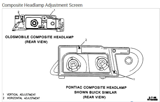

I was searching for a Headlight Adjustment Screw to adjust the height (and left/right) of my headlight, but was not really successful.
I think for Left/right there is no adjustment possible at all....
For Up/Down I found a little hole and inside I can see a kind of gear.
Is there a special tool needed what engages into the gear to turn the screw (which is quite rusted).
With a screwdriver it is nearly impossible to turn the gear.
Any suggestion welcome.

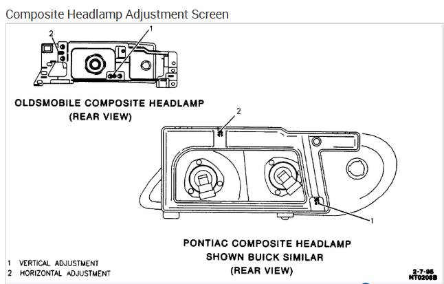

Yes, there are right and left adjustments. Check out the images (below). Let us know if you need anything else.

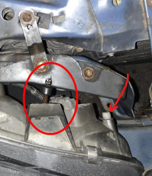

I just checked my headlights, but they look different.
I have attached two pictures and circled the potential screws.
I believe Pic_1 shows the two potential screws to adjust the headlights.
The one circled on Pic_2 shows the kind of gear inside, but as said, it is mostly impossible to turn it since the screwdriver can only move the gear inside a little bit.
Is there a special tool available connecting to the gear inside?

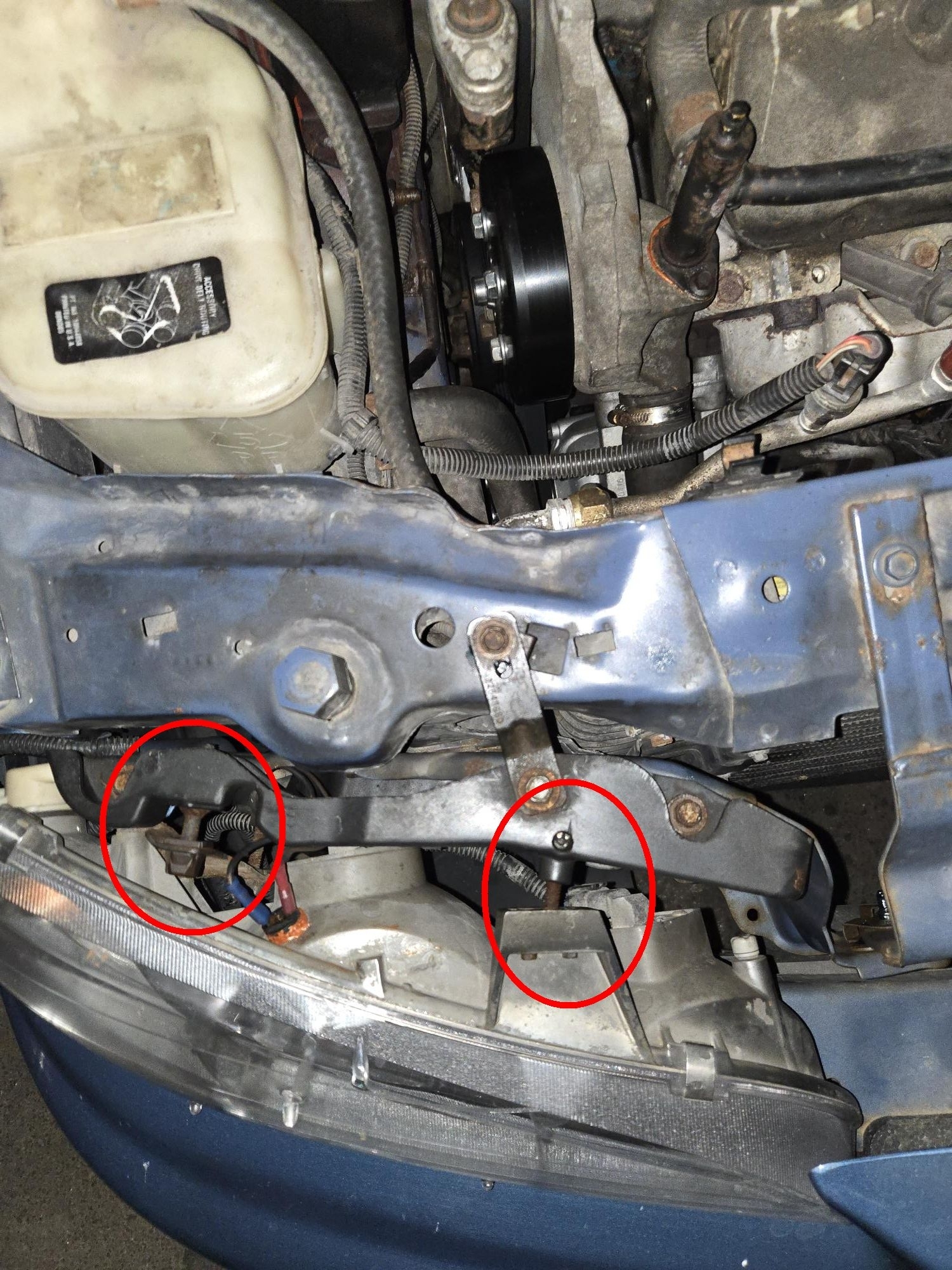

B767_400
  • 36 POSTS
Here is Pic_2.
The one where the Gear is in view inside the hole .... is the red cricle on the right.

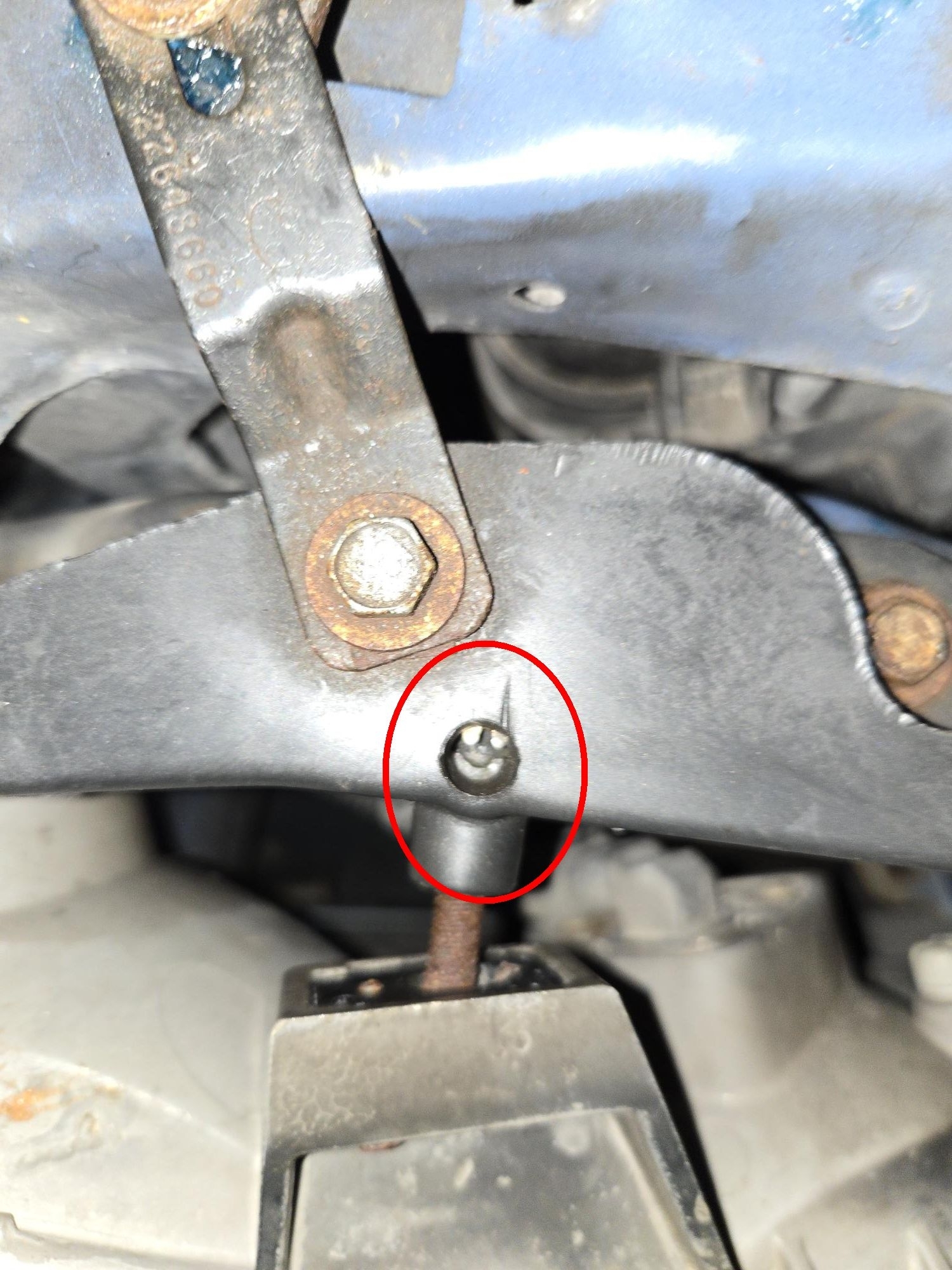

  • 54,494 POSTS
It look like someone messed up the head of the screw on the adjuster, this is where the other adjuster is I believe. Thanks for the images. Check out the images (below). Let us know how it goes
