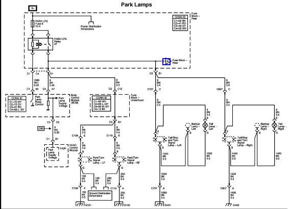

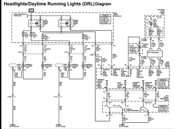

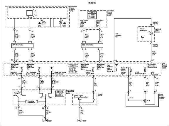

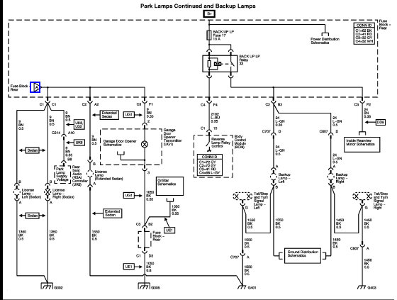

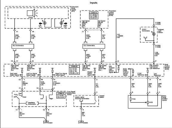

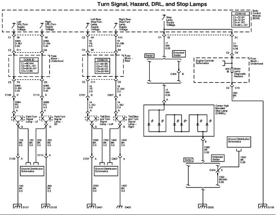

Need diagram of the headlamp wiring harness.
Saturday, May 19th, 2018 AT 5:22 PM
MECHANIC
110,192 POSTS
Hi and thanks for using 2CarPros. Com. The first schematic I attached is for the head lights. I then attached schematics for all exterior lighting.
I hope this is what you are looking for. Let me know if it helps or if you have other questions.
