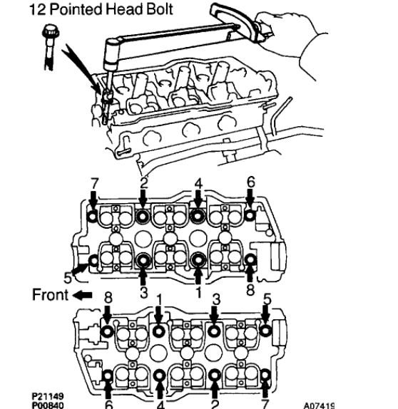

I need to know how much head-bolts-torque-specs-pattern-v6-please.

Good morning.
Procedure below and picture attached.
12 Point Head Bolts
Tightening Torque
Step 1. 34 Nm
Step 2. 90 degrees
Step 3. 90 degrees
Recessed Head Bolt Torque. 18 Nm
imageZoom/Print
Removal Sequence
imageZoom/Print
Torque Sequence
Warpage. 0.010 mm
Image (Click to make bigger)
