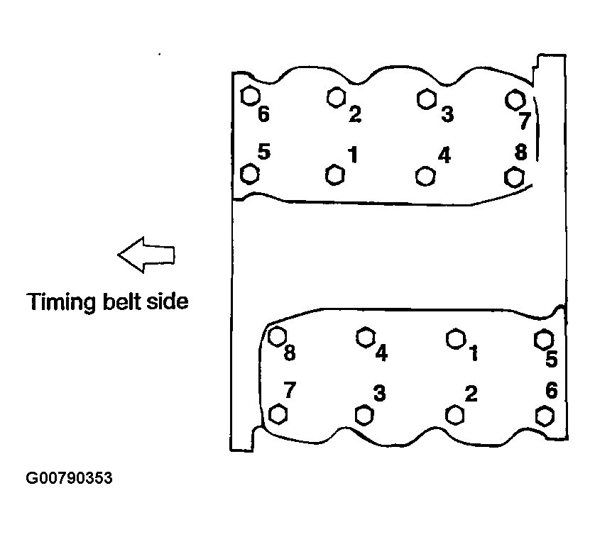

Replacing head bolts (new) but need to find out what are the torque specs.

18 ft.lbs. Then another 60 degrees. And then another 45 degrees. Follow the pattern in the image.

I forgot to add the bolt size is 12.
