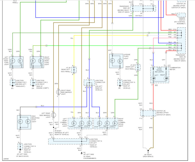

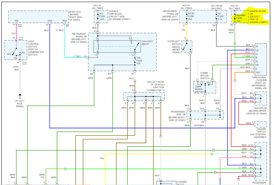

Hello, the vehicle hazard light is not functioning when the button has been pressed but both the left and right turn signal lights are functioning. What could be the cause?
Could I get I wire diagram for this?
Thank you very much.

There is a fuse specific to the hazard lights. It's fuse 15 in the under-hood fuse box. However, I believe that is for the signals as well. If they are working, I suspect it will be good.

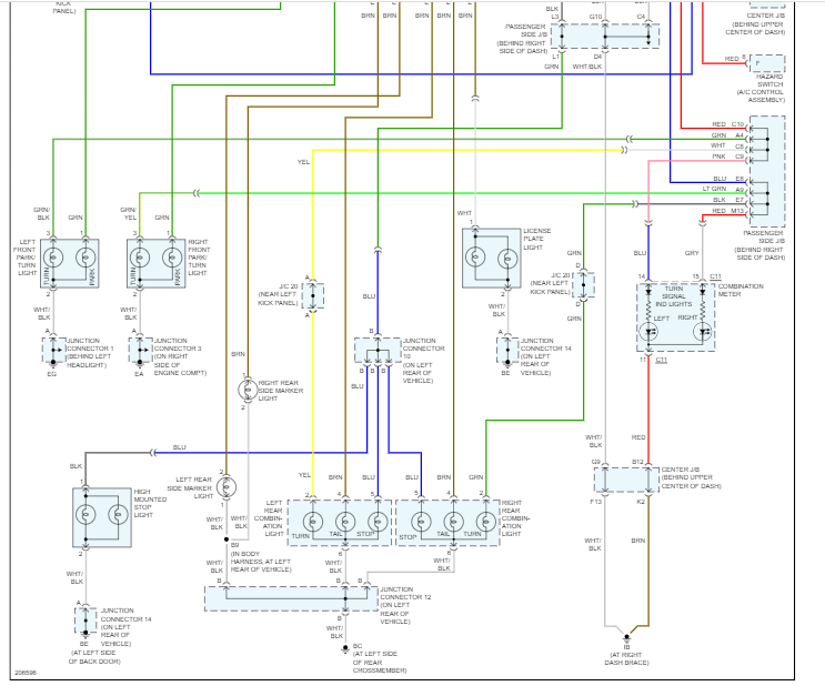

I attached the wiring schematic for you below. As always, I cut it in half but overlapped it so you can follow from one to the next.
Let me know if this helps.

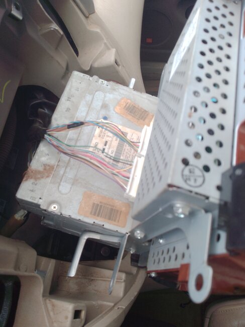

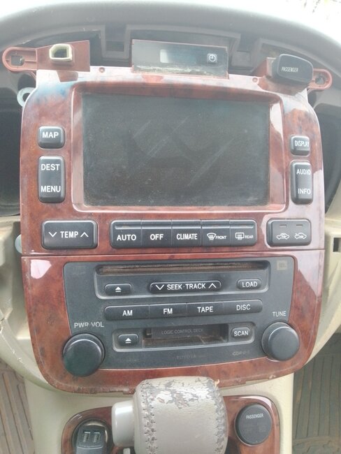

The hazard fuse is okay, I wanted to test the hazard switch but when I removed it. It was assembly. I don't know how to test it and there are two red wires on the connectors, if I have to use the wire diagram.

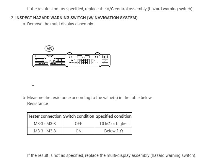

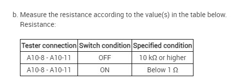

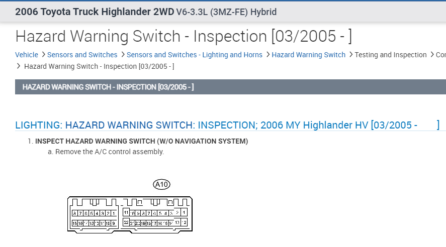

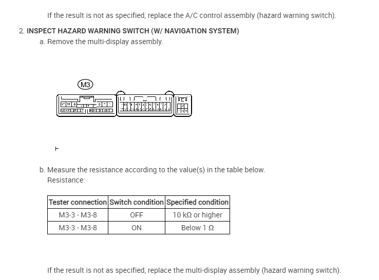

I see that. I do see two reds going into the center JB in the schematic. Do me a favor. Take a look at the diagnostics for the hazard lights circuit below. One is for a vehicle with navigation and the other is for one without.
Let me know if you are able to test from that information.

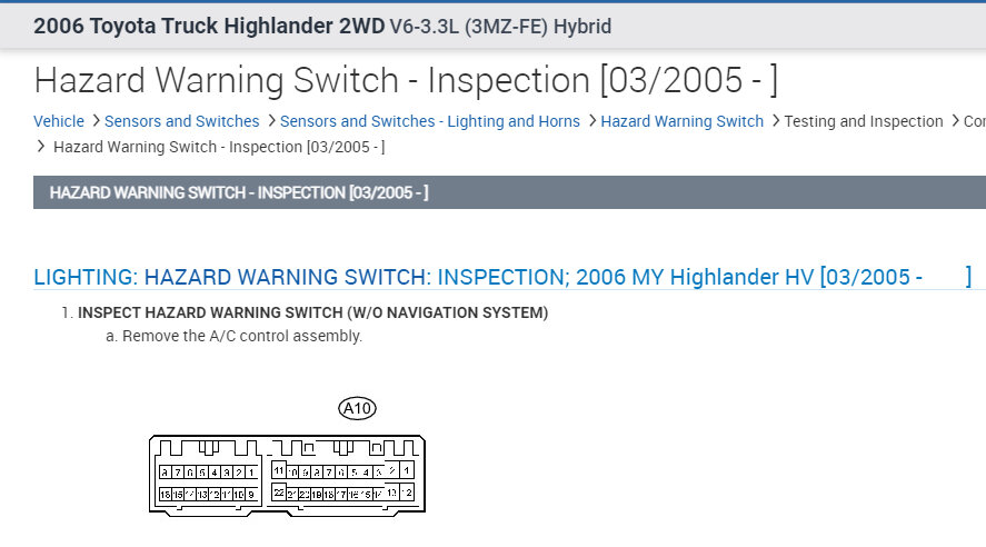

Thank you very much for the information.
From the picture that I sent, it seems that the vehicle that I am working on is without navigation, if I am right?
Then from the guide, does it mean that if the switch is bad, the A/C assembly will be replaced, or can the hazard switch be replaced alone?
Tuesday, September 5th, 2023 AT 8:37 PM
  • 110,192 POSTS
You should be able to replace only the switch. It has been a while since I've seen one of these, but the switch should be separate.

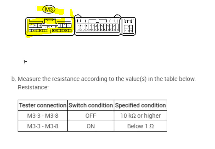

From the A10 has two connectors. Which of the connectors, will be tested for?
Wednesday, September 6th, 2023 AT 8:13 PM
  • 110,192 POSTS
With the switch off and on, you are checking resistance as indicated in pic 2 above. Is that what you needed?

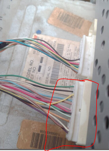

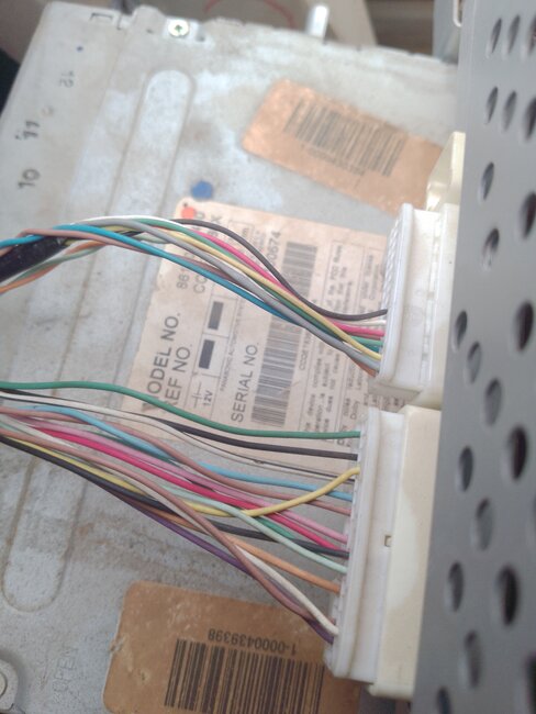

I mean two different connectors entered the A/C assembly. Which of the two shall we test for?

See pics below. When determining pins, turn the connector in the same direction as indicated in the pic.
Let me know if that is what is needed.

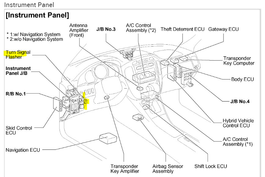

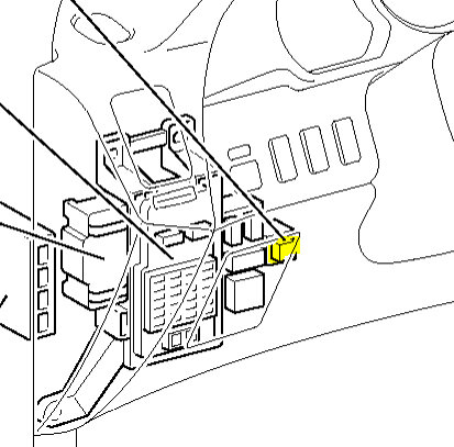

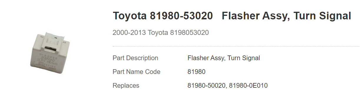

Please could I have the location of the turn signal flash assembly?
Tuesday, September 19th, 2023 AT 12:12 PM
  • 110,192 POSTS
The signal flasher is under the dash on the left side next to the IP junction box. See pics 1 and 2 below. Pic 3 provides the part number and what it looks like.
