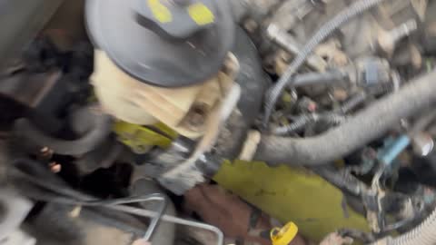

The second video is another issue I’m having. It takes forever to get it to crank

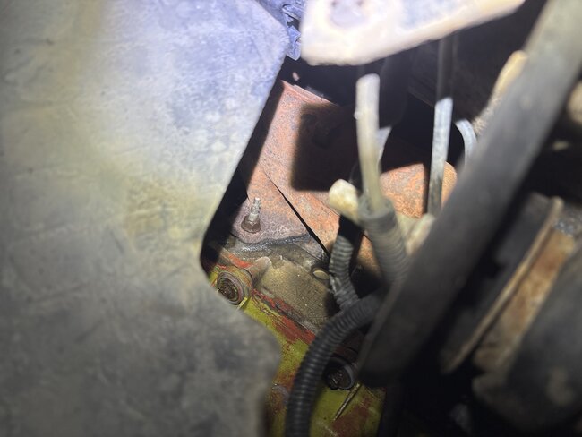

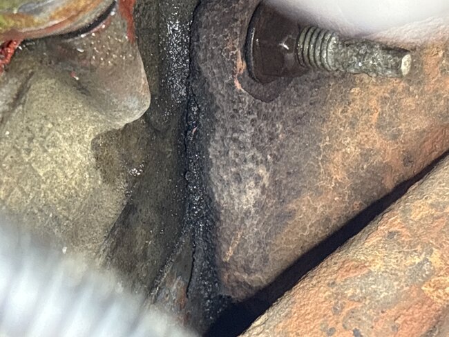

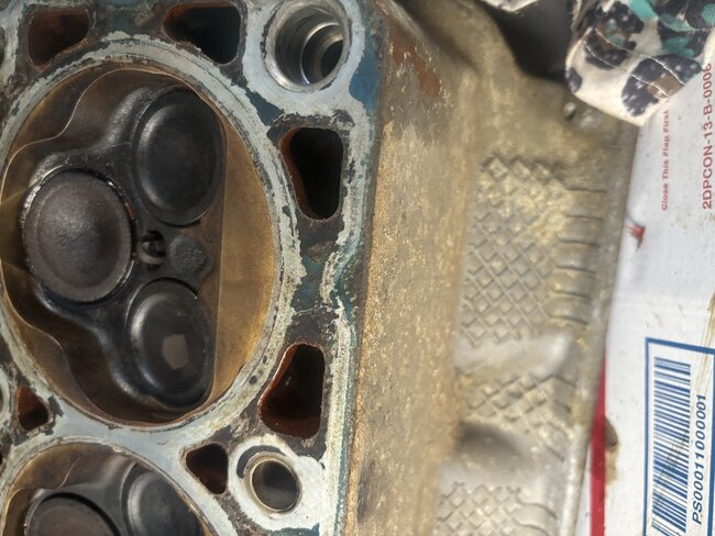

I tried to get a picture of a spot on my manifold. That’s the only bad looking spot on it.

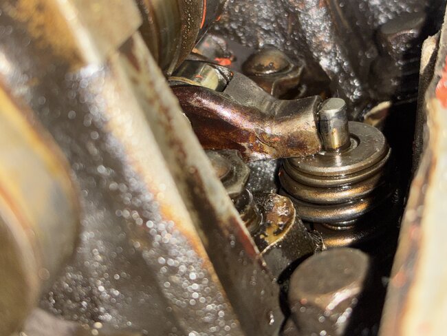

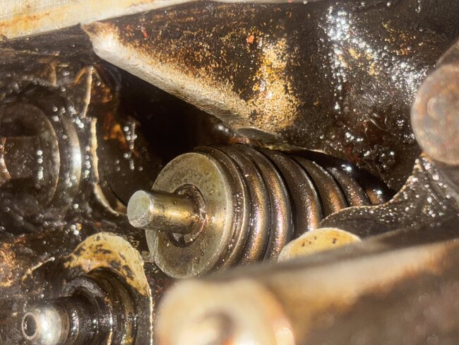

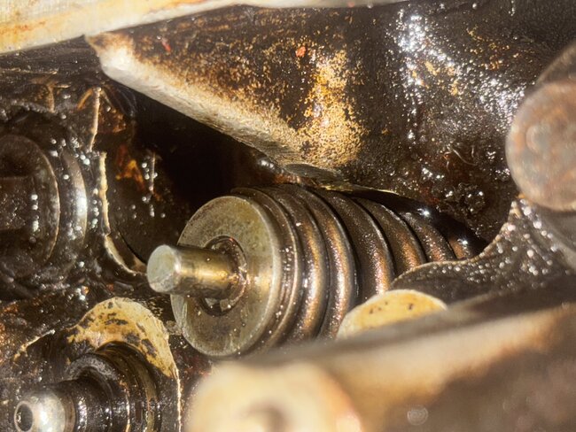

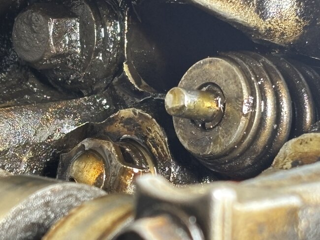

Well, I came out today in this freezing cold wind and took my valve cover off... The last set of three rocker arms, the middle one, the side that is supposed to sit on the keeper, it’s not on it. I can touch the valve stem. So I’m going to replace the roller followers and hopefully that solves my issue
Sunday, December 14th, 2025 AT 2:51 PM
DANNYBOYATWOOD
  • 25 POSTS
And yes I know the inside of my engine is trash but I just need this baby to last me a little longer until I get financially stable enough to afford another truck! But you can see
Sunday, December 14th, 2025 AT 2:54 PM
KEN L
  • MASTER CERTIFIED MECHANIC
  • 55,335 POSTS
Yep, you found the problem, nice work. Did the roller follower jump off of the lifter? Thanks for the image, it helps.

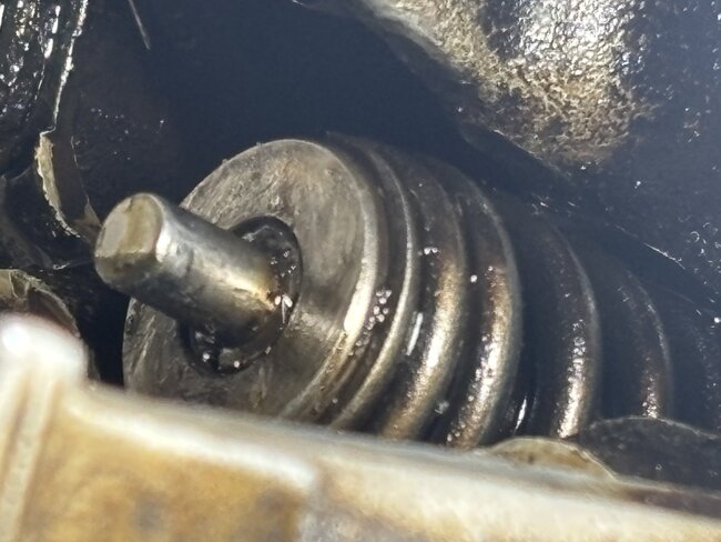

No it stayed on my lifter. The valve stem and spring slipped out from under the roller follower. I’ve been fighting with it every evening this week but I can’t seem to keep the valve stem from slipping out from under the roller follower. Probably because the edge of the valve stem got sheered a little when it messed up. I took a picture. Do you have any suggestions? I’m REALLY not wanting to pull the head! I’m constantly working and can only put my hands on it maybe 30 minutes after work! If you look real close at the picture you can see where it’s a little flat on one side. And does it look like my keeper is broke? I see it has a bigger gap than my other ones. Maybe that’s why? Any suggestions would be grateful! You’ve been a lot of help!
Friday, December 19th, 2025 AT 7:34 PM
KEN L
  • 55,335 POSTS
I got ya, yep I see the valve damage, the reason I asked of the rocker fell off of the lifter is because it looks like the valve is bent outward and that is why you have that kind of wear/failure. So the head will need to come off. Here is a video that can help, you will need to deal with the timing chains as well.

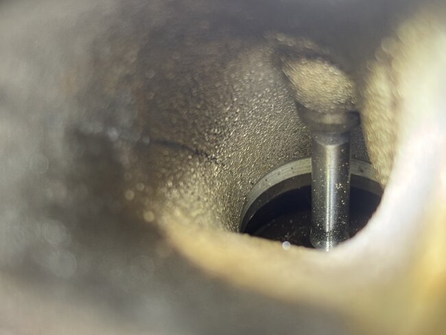

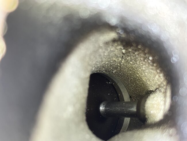

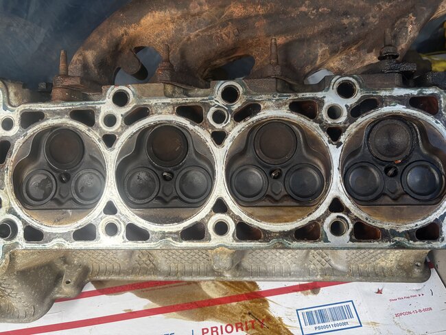

Yes sir I watched the whole 5.4 rebuild series about a year ago when I replaced my timing chain and phasers. I just now got my phaser and camshaft off and I’m sending you pictures of the valve spring and picture of what I see inside the holes where my intake sits. So inside cylinder 8, it doesn’t look like either valve is fully seated like they are in the other 3. You can see in the second picture (cylinder 8) then the 3rd picture is cylinder 6.
Monday, December 22nd, 2025 AT 7:31 PM
KEN L
  • 55,335 POSTS
Yep, that's a bummer. The valve is open when on rocker is on it, this means the head needs to come off and a valve job done. Sorry, it looks like the valve seized in the guide which happens. Thanks for the images. Let me know how it goes, Ken

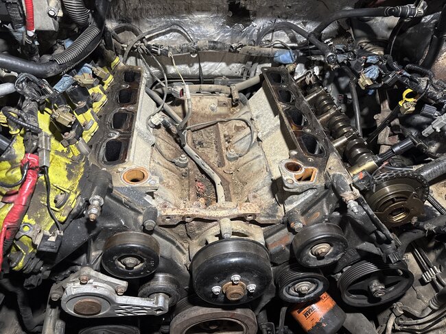

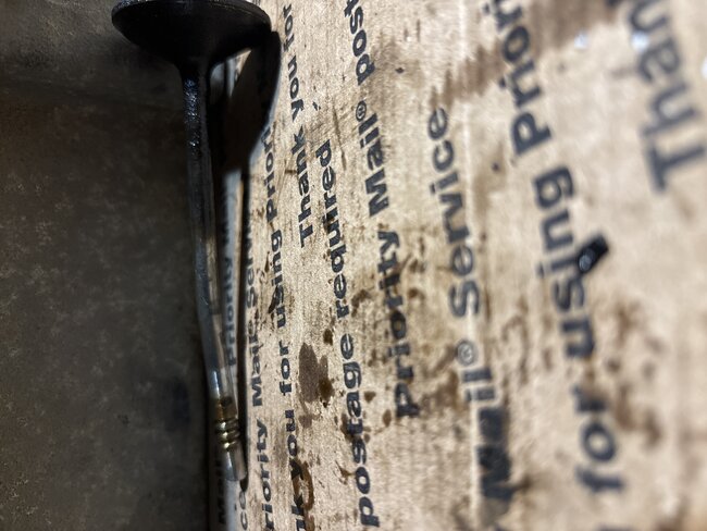

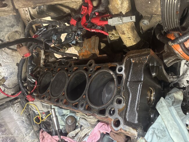

Good afternoon Mr Ken, I finally got the cylinder head off my truck! It wasn’t that bad of a hassle! I also found that my passenger side cam phaser was broken so I have to get it replaced but luckily it’s got warranty. I’ve ordered my gasket kit, head bolts, valves, springs, keepers and valve seals. Just waiting for them to come in and since I’m already this deep into the top end I’m going to also pull my passenger side head and rebuild it also! I’d rather do it now than to just do the left side and end up having to tear it all out again in order to do the right side! I sure can’t wait to get this all done! I miss my truck and I miss not having to beg for rides to work every day! I’m adding some pictures also!
Saturday, December 27th, 2025 AT 12:49 PM

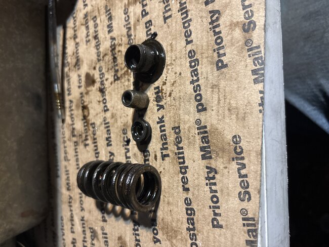

Welp I got the bad valve and spring out and now I found that the valve guide broke also! Any advice to getting the broken guide out?
Saturday, December 27th, 2025 AT 8:18 PM
KEN L
  • 55,335 POSTS
Nice work, yep that is the problem there. The valve guide will need to be installed by a machine shop or I would get another cylinder head (used) from ebay. Is there piston damage on that cylinder?
