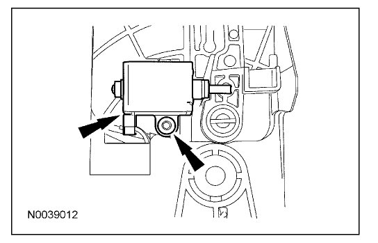

Hello Guys, it is me again. Would you help me fix the problem with my vehicle listed above? Almost every time I cold start and often after it warms up I have trouble shifting out of park. I need to pump the brakes several times and click the shift trigger many times before it unlocks the shifter. I can hear what sounds to me like a solenoid clicking at times but still not releasing the trigger. Ford did a “temporary” fix that lasted a few weeks, now I would like to give it a try. Is this repairable and without dropping the transmission? Thank you, Gary K.

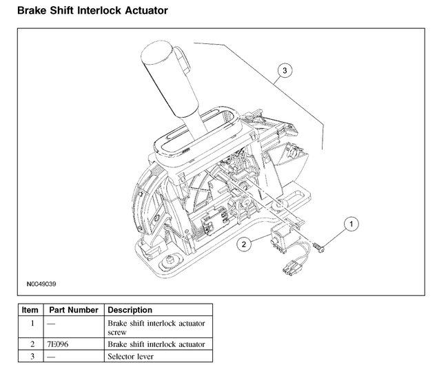

It sounds like the interlock solenoid is damaged/failing. If you hear the click of the solenoid but it still does not release then it is probably the link on the solenoid or the arm it connects into. The images show the solenoid and the arm it connects into.
They are on the side of the shifter assembly under the console inside the truck.

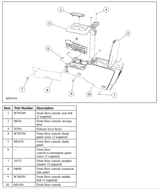

Removing the console is not hard, just takes a bit of time. Put the seats all the way back and remove the two rear console bolts (1 in picture). Remove the shifter bezel (3 in picture), gently pry it up and it will come loose. Open the lid and remove the screws (4 in picture) that hold the larger trim panel around the shifter.
Disconnect the electrical connector that feeds the console.
Remove the front push pins (7 in picture) and the trim panels.
Remove the two bolts (9 in picture). Pull the console back and lift it up, remove it and the shifter will be right there.
If you look at the solenoid it retracts and pulls the interlock lever back to release the shifter out of park. It should still operate with the console out so you can test it. You have a couple options at this point depending on what you find. If the solenoid is bent or does not activate every time you can replace it. It is also possible that the circuit board that it plugs into is failing. Try wiggling the connectors and see if it starts working again. If it does the board is easy to replace as well.
If the problem is the link arm, that is probably a dealer or used only part.
I cannot tell you that you also have the option of removing the interlock if you wish. But once you see how it works it is your choice.

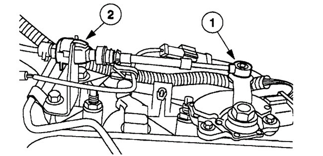

Good afternoon,
Does it go into reverse okay?
This sounds like the shift cable itself.
Selector Lever Cable and Bracket
Removal
1. Raise and support the vehicle.
ImageOpen In New TabZoom/Print
2. Disconnect the shift cable from the transmission.
1 Disconnect the shift cable from the manual control lever.
2 Depress the lock tabs and disconnect the shift cable from the shift cable bracket.
3. Remove the bolts and the shift cable bracket from the transmission.
4. Lower the vehicle.

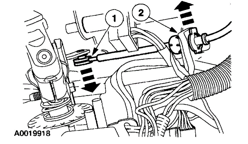

5. Disconnect the shift cable from the steering column.
1 Disconnect the shift cable from the transmission selector lever arm and support.
2 Disconnect the shift cable from the steering column bracket.

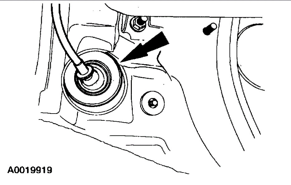

6. Push the rubber grommet through the bulkhead.

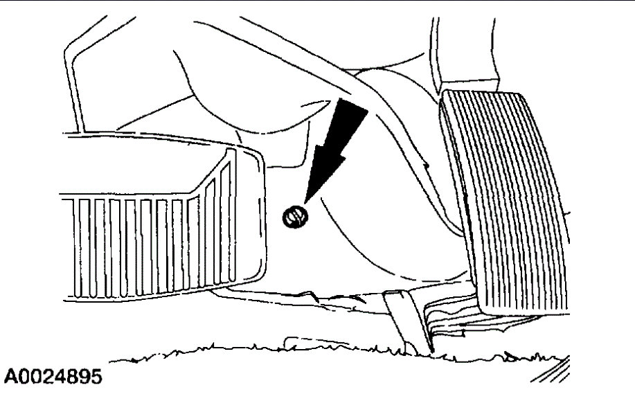

7. Locate the shift cable retainer tabs, protruding through the floor pan, underneath the carpet and insulation. While squeezing the tabs together, push the tabs out of the floor pan.
8. From the engine compartment, remove the shift cable from the vehicle.
