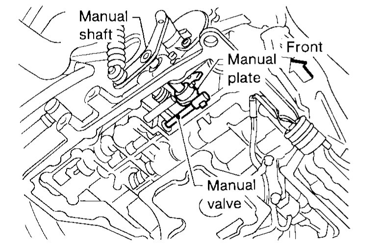

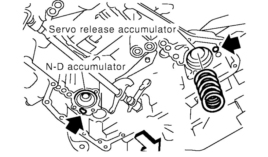

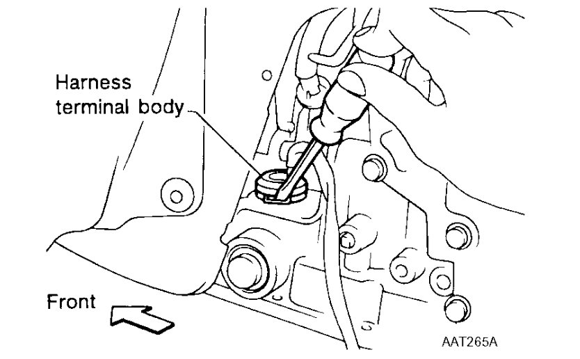

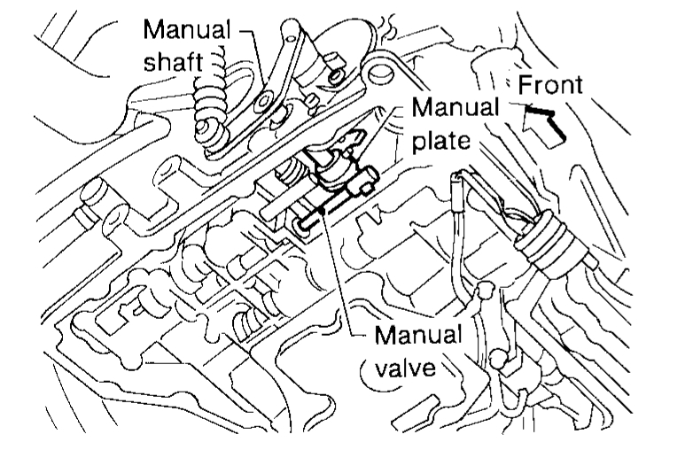

It looks like you did a good service. did it shift okay before the serviced? If it was shifting before the service we need to back step the service. Fist make sure there no blown transmission fuses.Be careful not to drop manual valve and servo release accumulator return springs.
Disassemble and inspect control valve assembly if necessary.
Remove servo release and N-D accumulators by applying compressed air if necessary.
Hold each piston with a clean, lint-free towel.

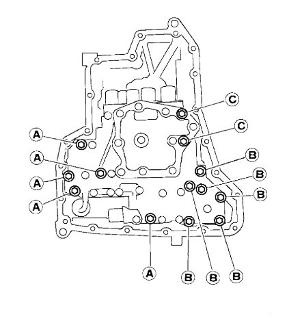

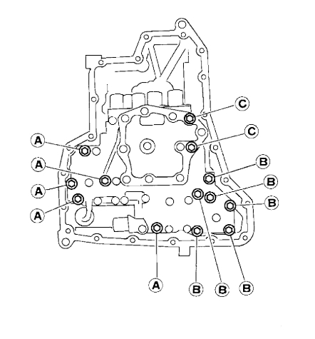

Set manual shaft in Neutral position, then align manual plate with groove in manual valve. After installing control valve assembly to transmission case, make sure that selector lever can be moved to all positions. (Make sure all the valve body bolts go back into the same hole they came out off). Make sure the filter is sealing and no cracks.
