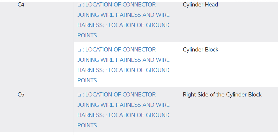

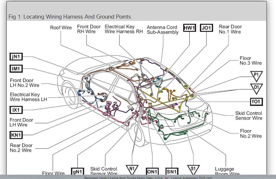

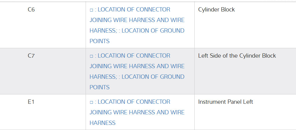

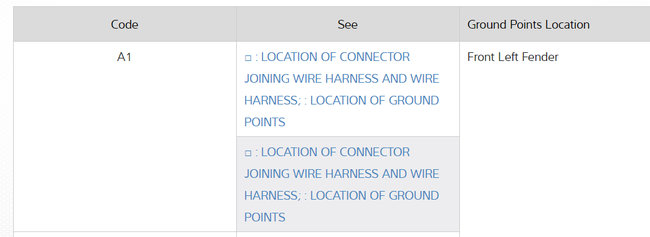

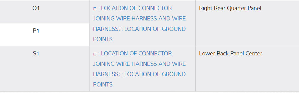

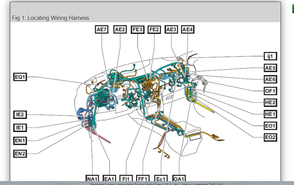

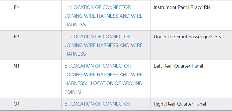

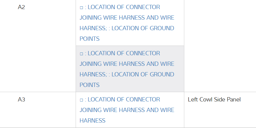

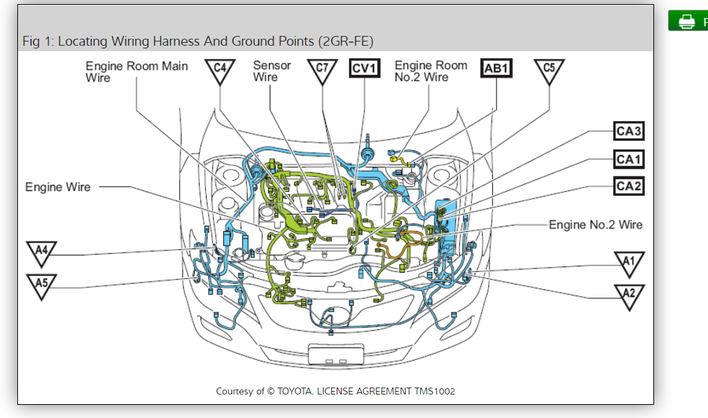

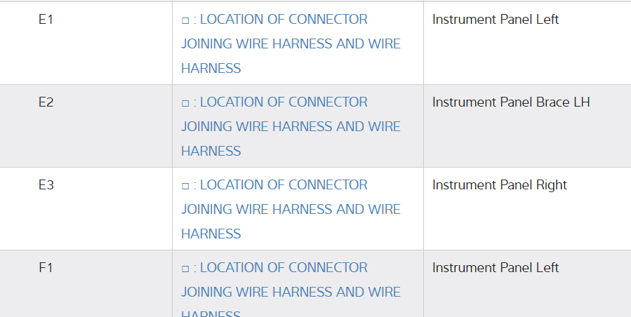

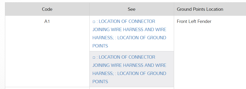

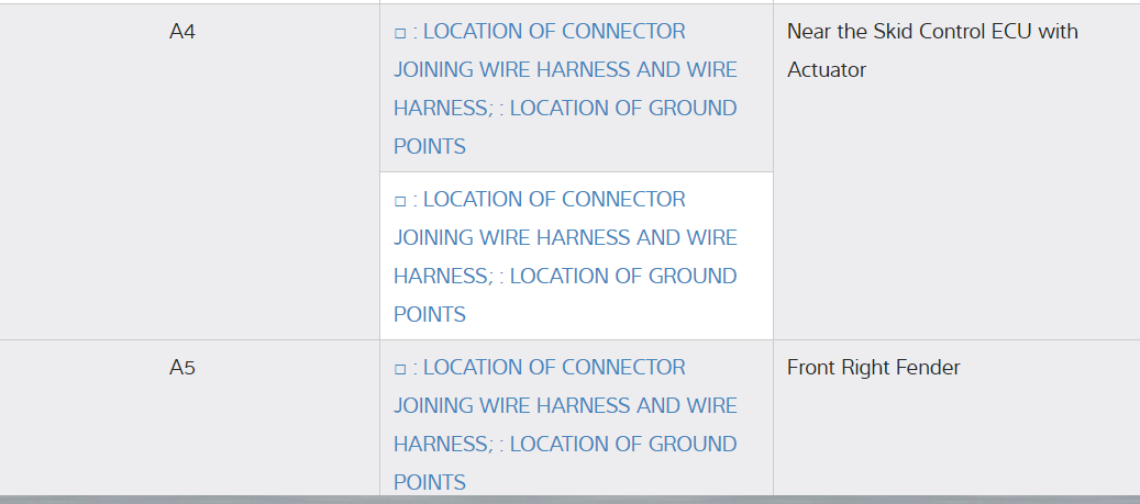

Could you point me to where the ground wires from the chassis to the engine block are located? Is there more than one? Thank you for your time.
Jul 22, 2019 at 4:56 PM
SCGRANTURISMO
  • 4,897 POSTS
The information that you requested is in the diagrams down below. Please go through these wiring diagrams and Ground location diagrams and get back to us with how everything progresses. And should you have any other vehicle related questions, please feel free to ask, that is why we are here.
