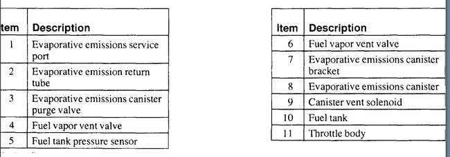

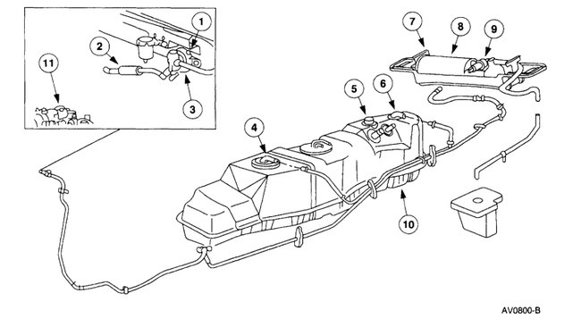

Emissions. I have a gross leak. Replaced gas cap and vapor solenoid. The small lower vapor line coming from the bottom of the solenoid is cut. Where does it attach to on the engine?

I have included an exploded diagram of your vehicle's EVAP system in the diagrams down below for you. Please go over the diagram and get back to us with what you are able to find out.
Thanks,
Alex
