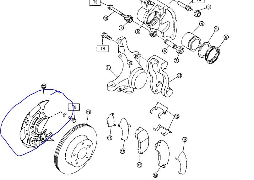

It sounds as if there is another piece of metal between my rotor and my brake pad. Both of which are brand new. Almost as if the caliper itself is grinding on the rotor.
Possible/probable causes? Caliper? Loose wheel hub nut? CV? Tie rod?
Everywhere I've looked says the rotor..

As far as the noise, check the backing plate behind the rotor and see if it is bent and too close to the rotor giving you this noise. It is not uncommon for this plate to get out of shape during a replacement of pads and rotors.

They're Duralast ceramic brake pads. I did look behind the rotor, the plate doesn't appear to contact it.
But, I did notice that once i had it all put sick together and on the ground, I could reach through and feel the rotor's outer rim (parallel to the wheel) is smooth, i.e. grinded down.
