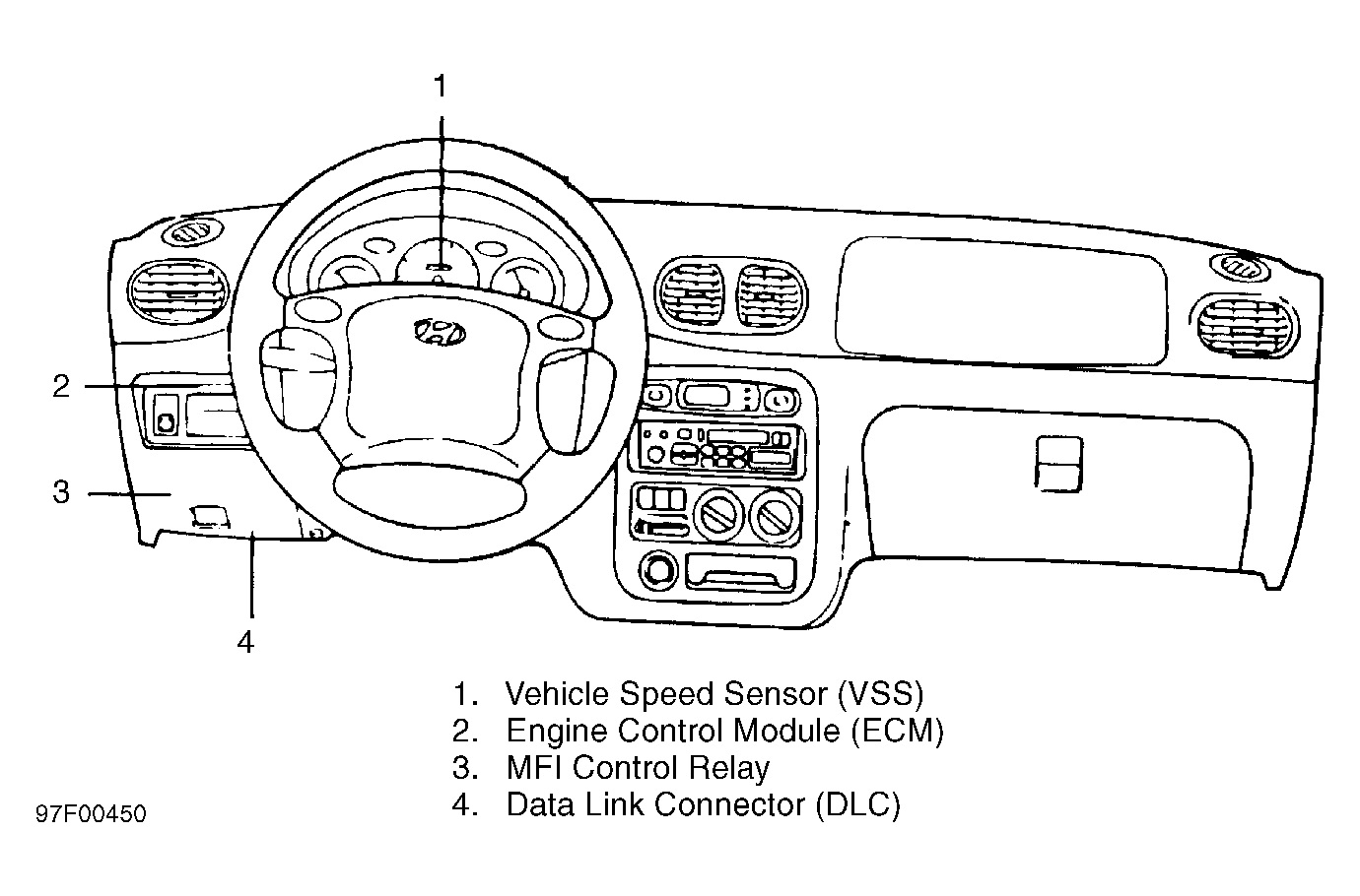

Where is the out put speed sensor located did test it said speed sensor has no signal

The only reference I can find says it's on the speedometer head in the instrument cluster.
