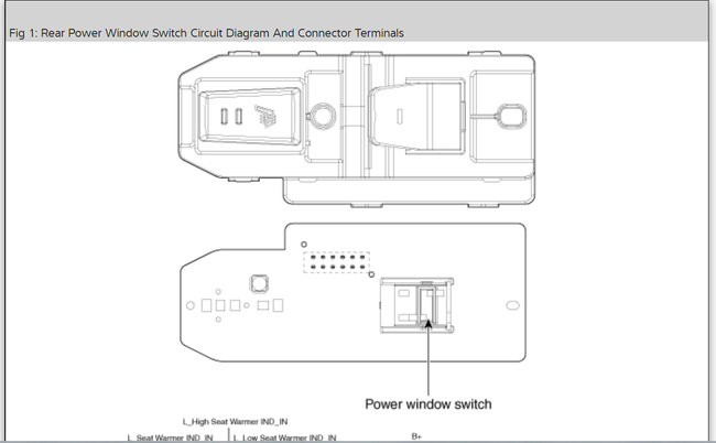

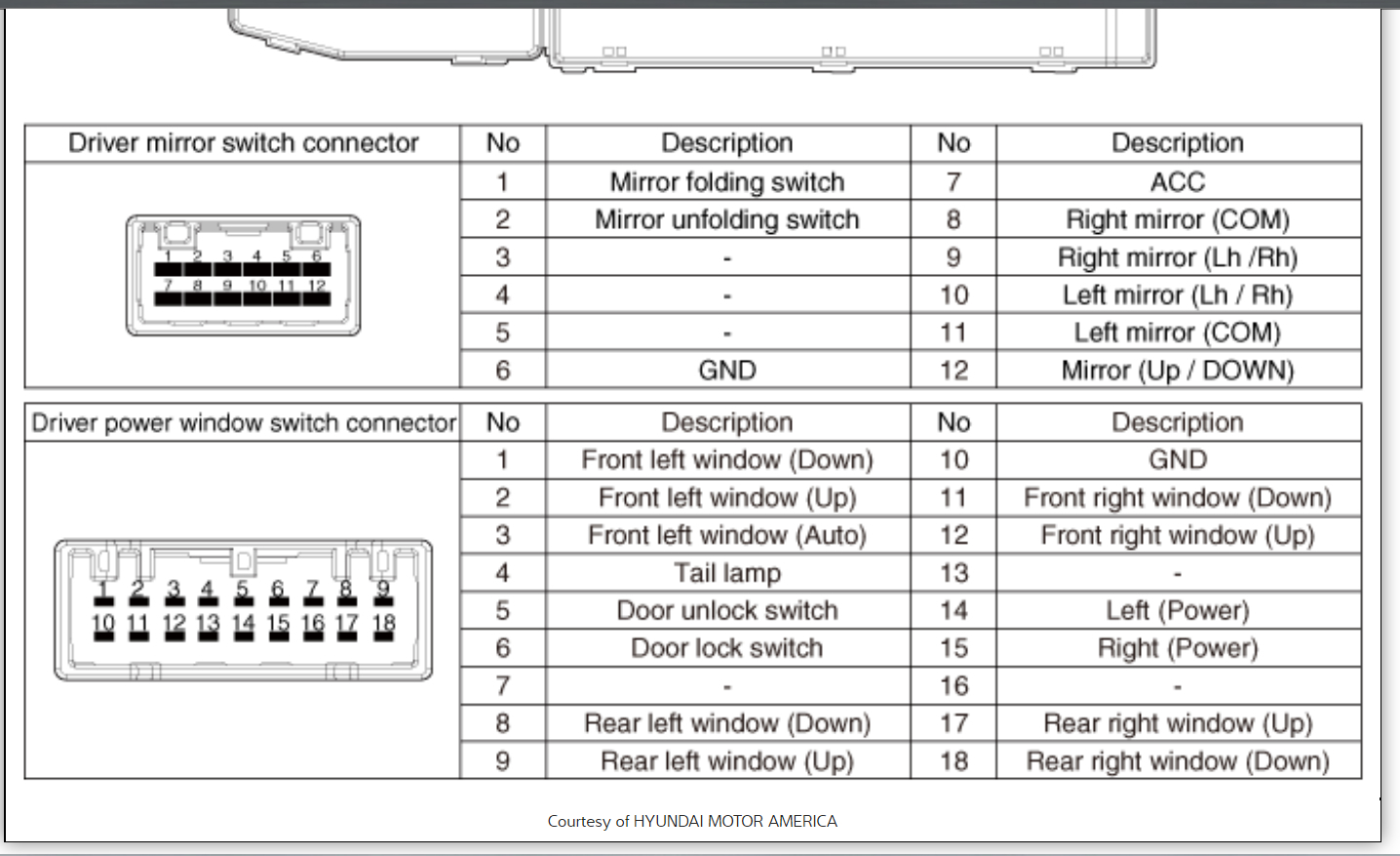

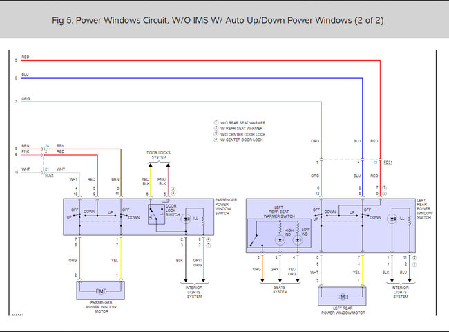

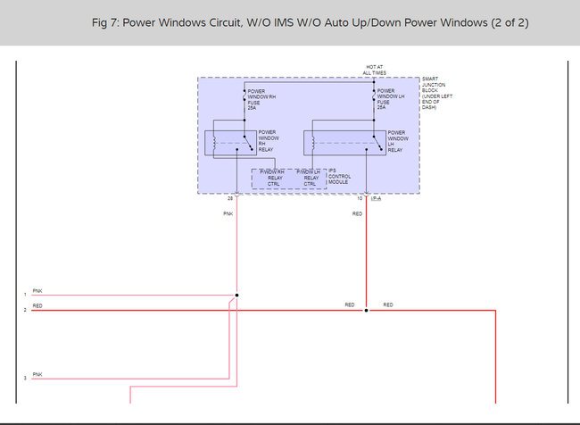

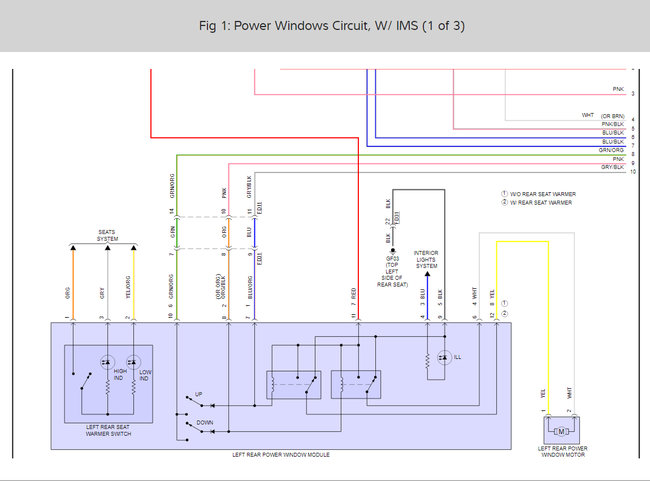

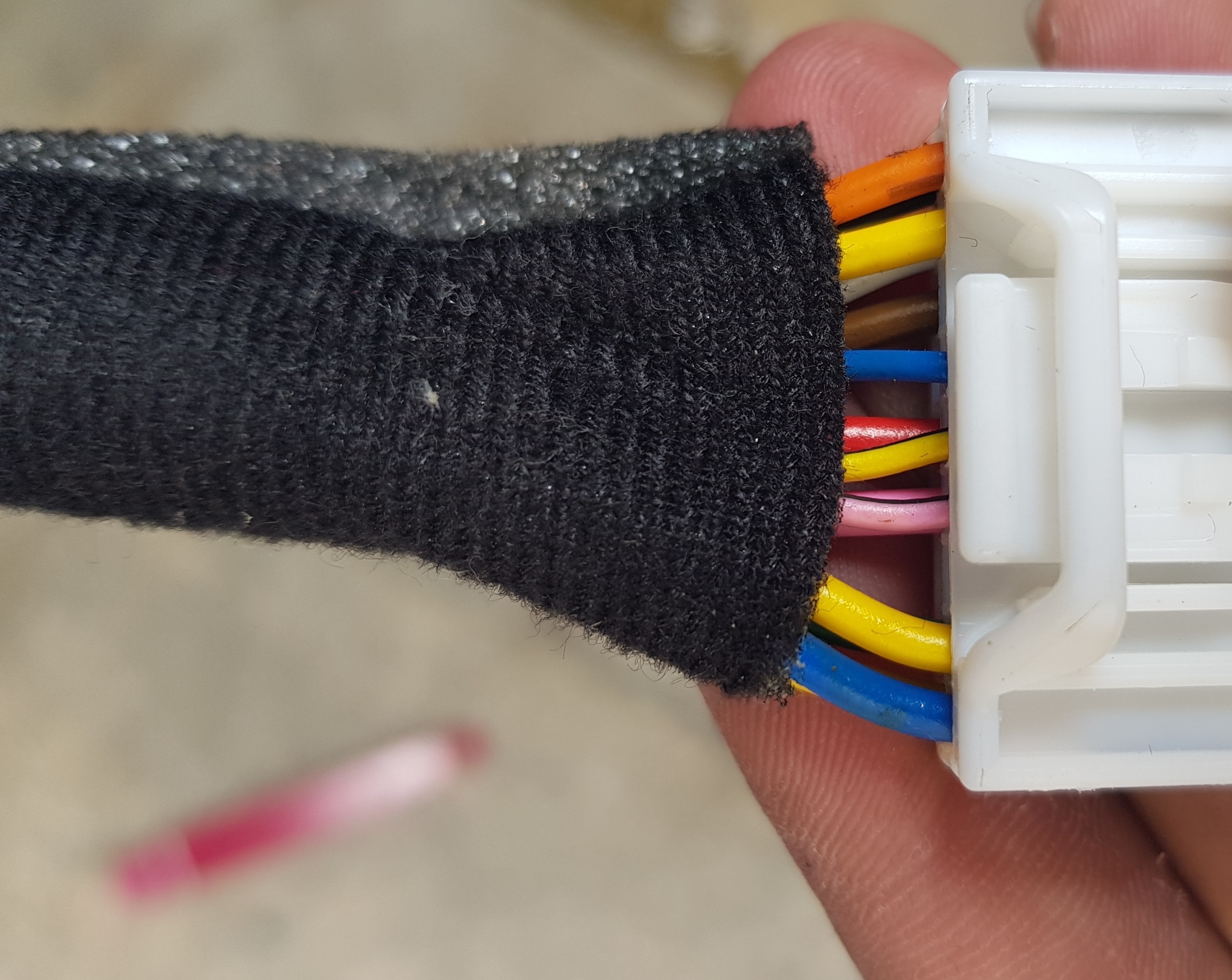

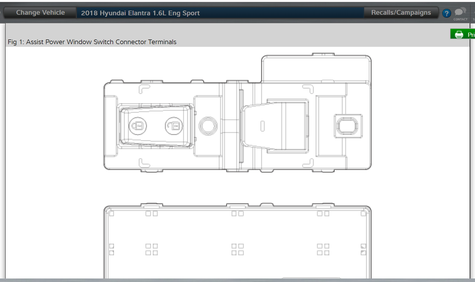

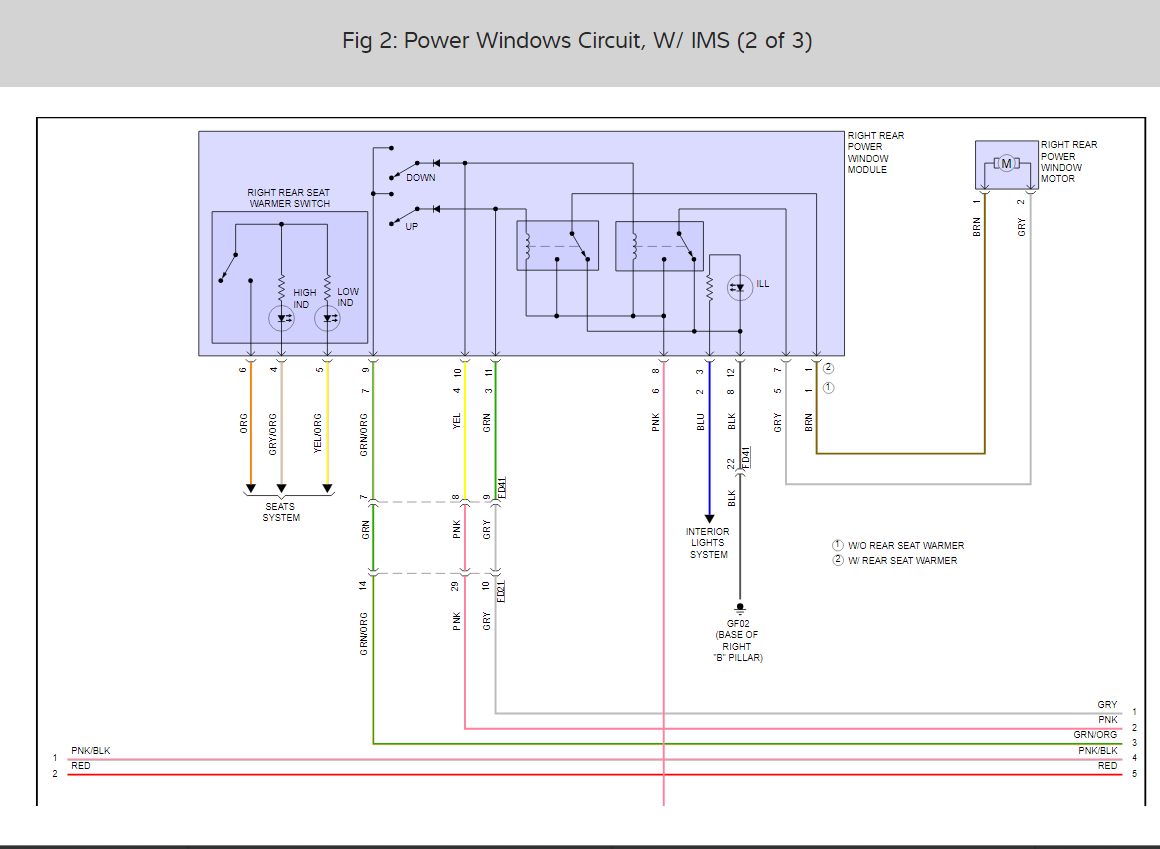

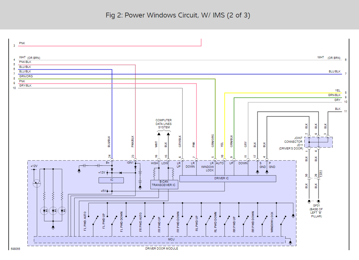

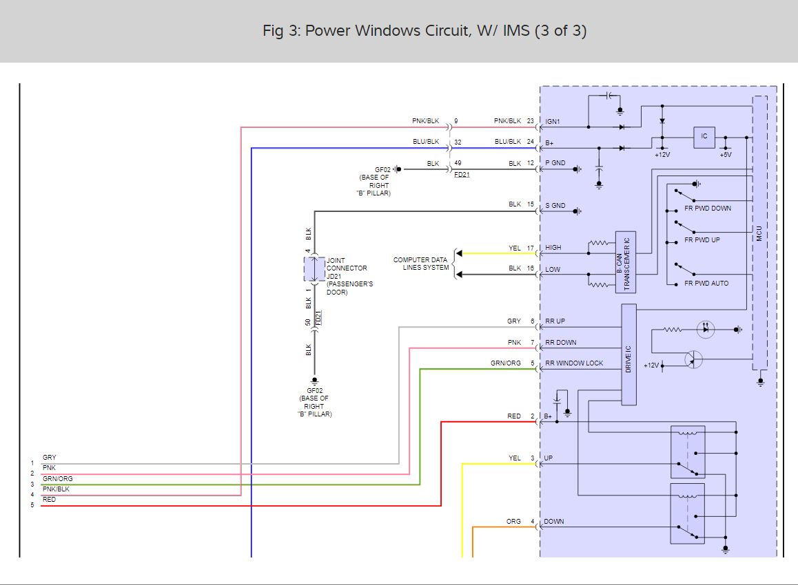

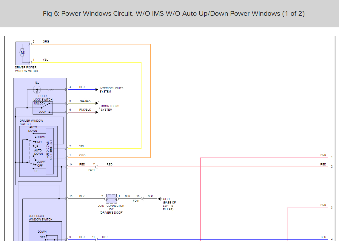

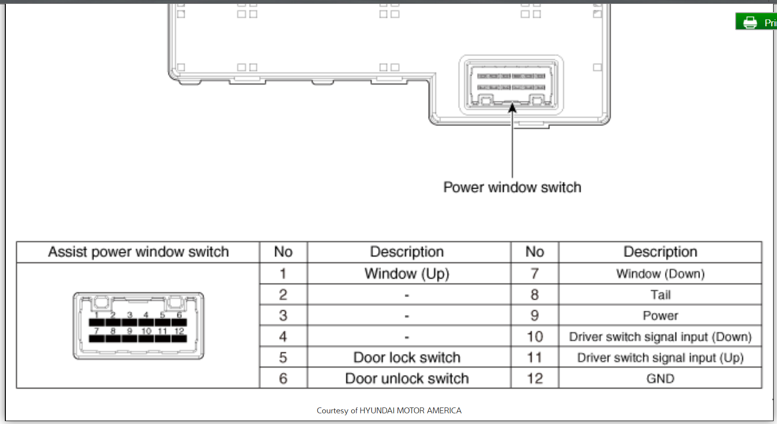

I need to install auto open and close window in my car. Can anybody show me the power window wiring diagram? Thanks

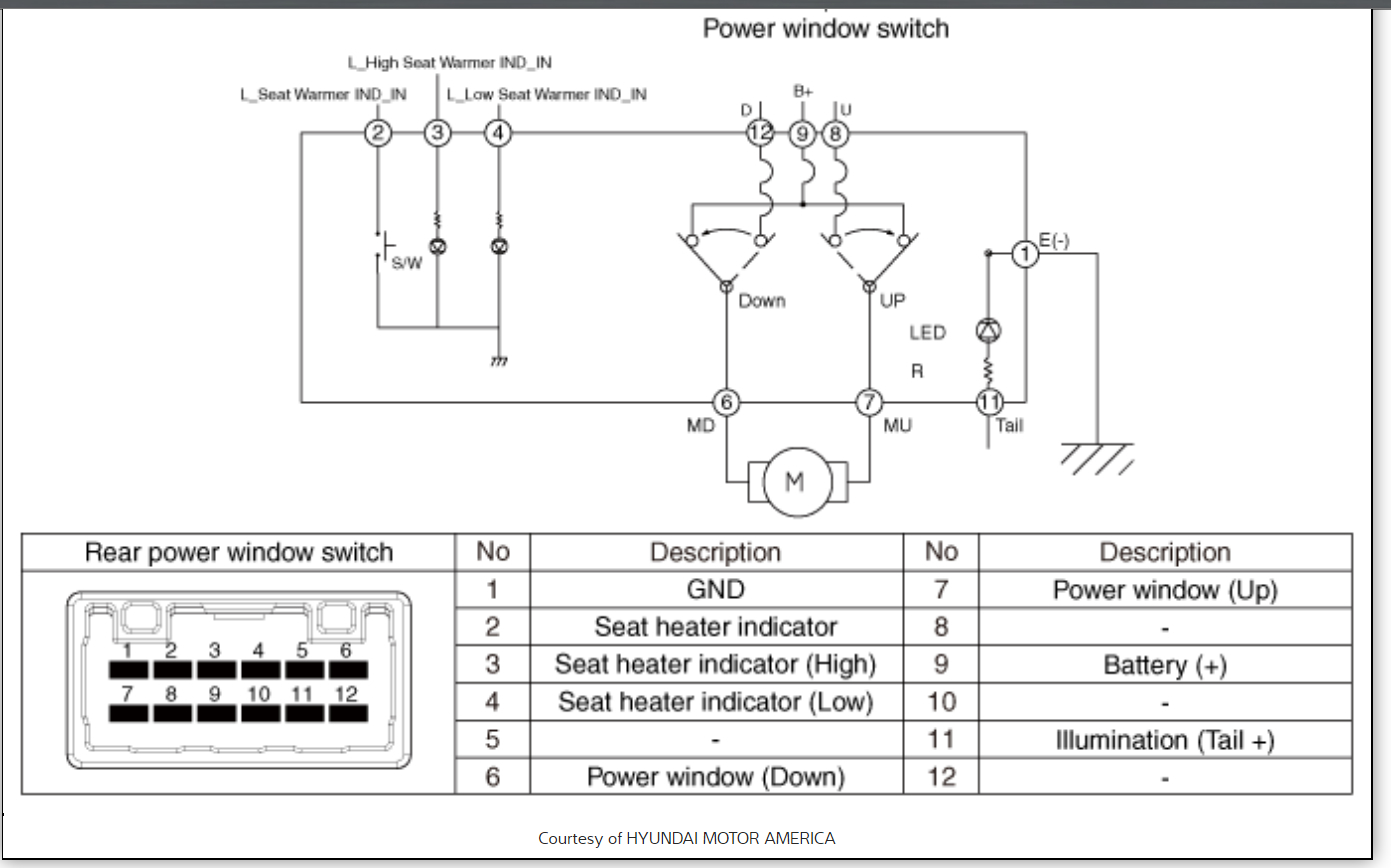

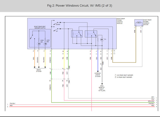

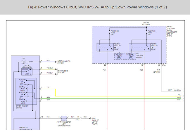

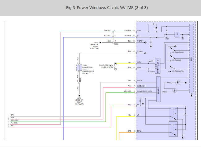

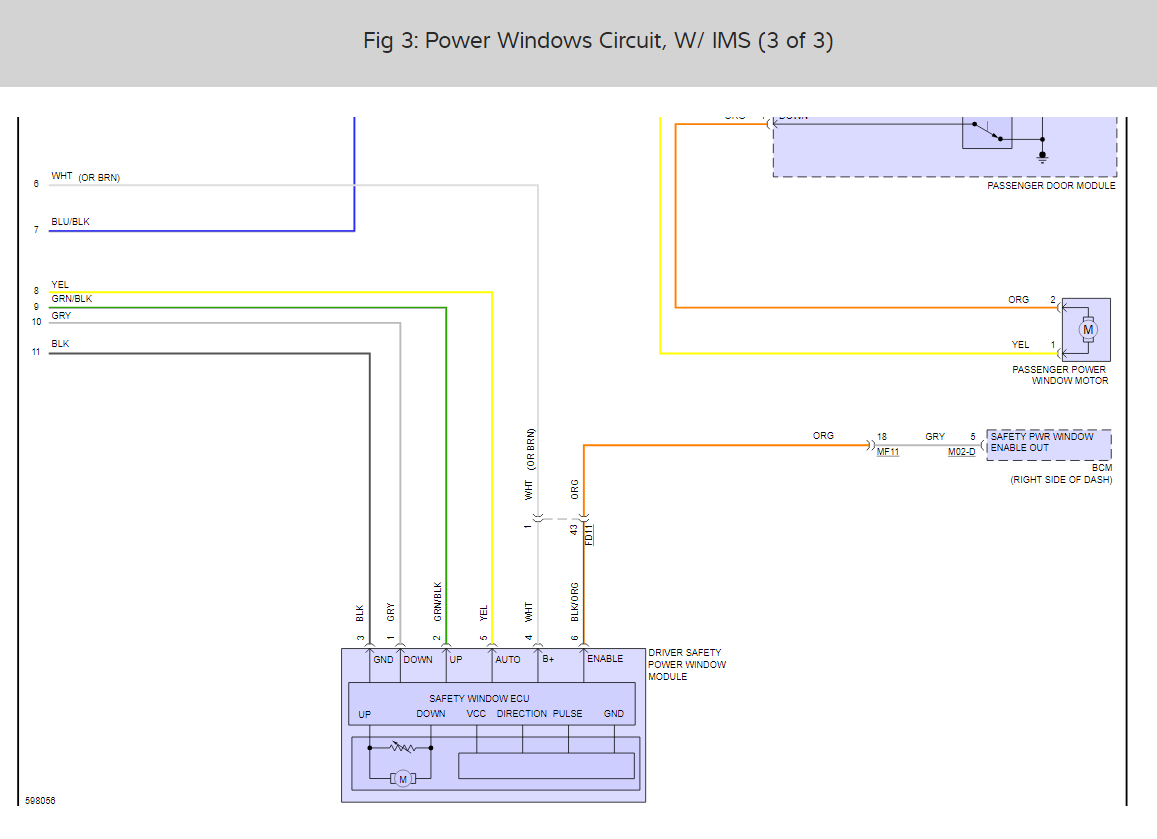

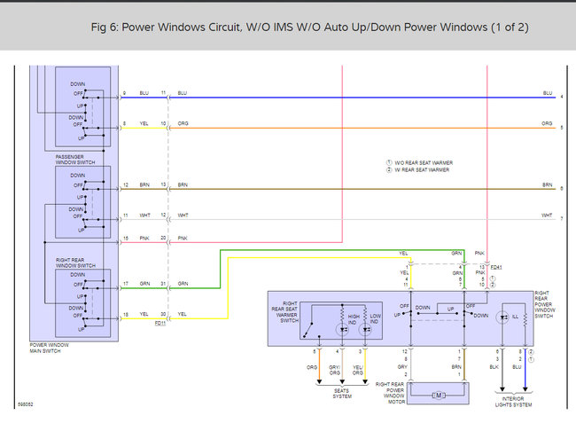

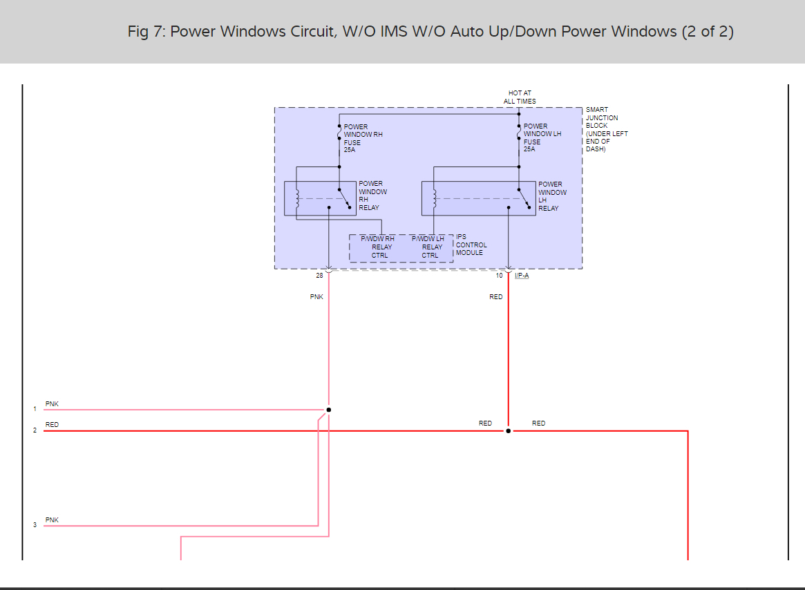

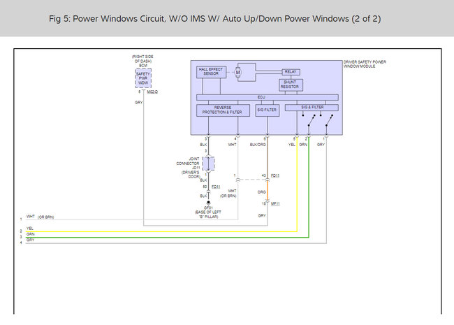

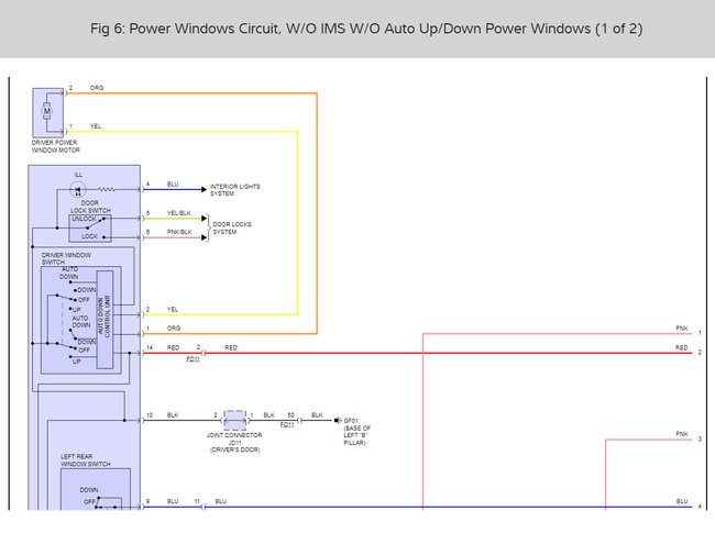

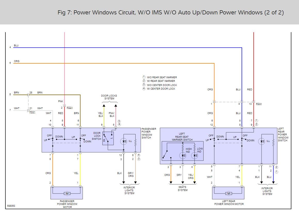

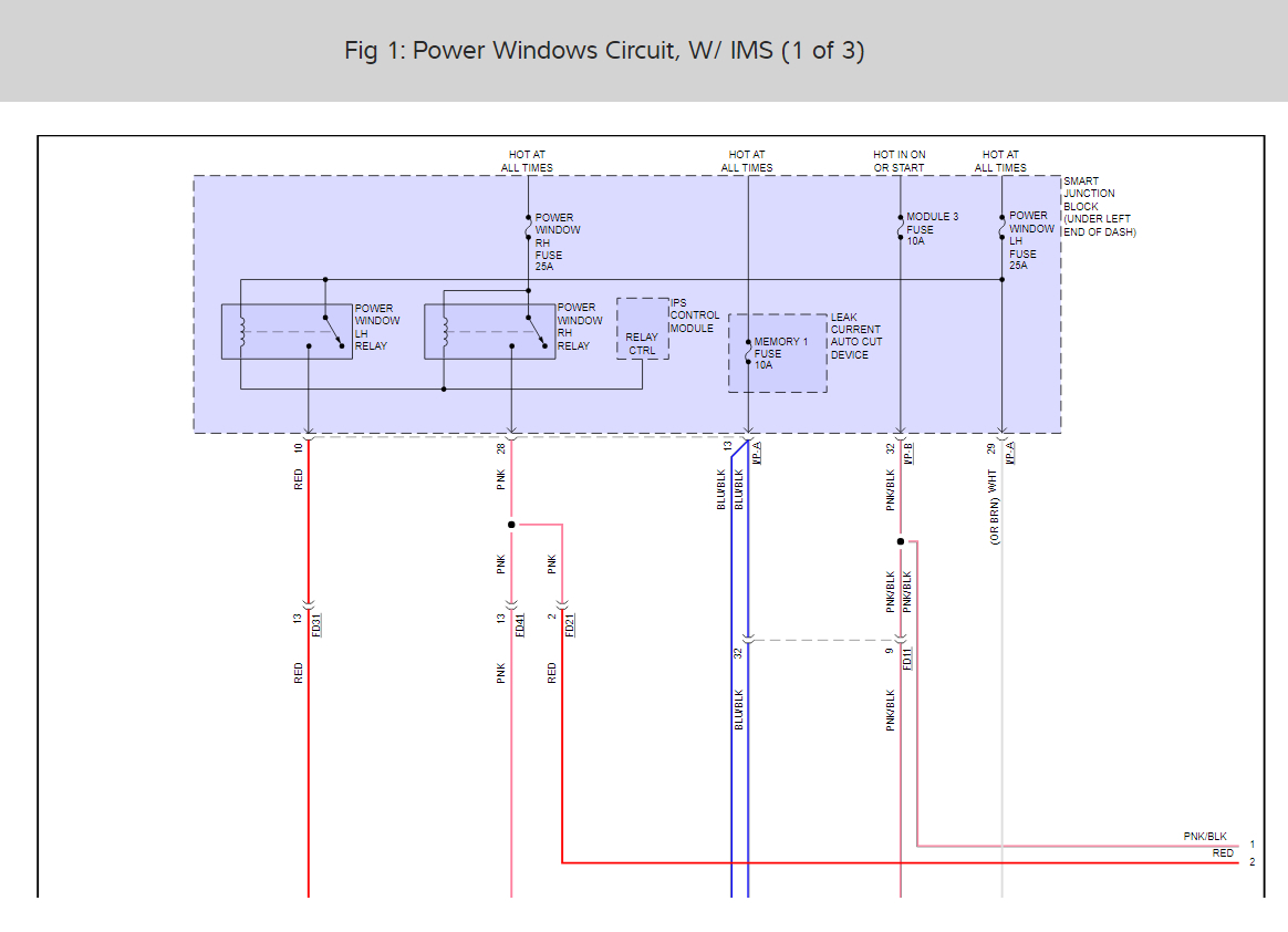

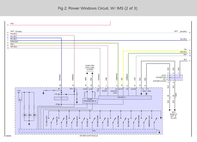

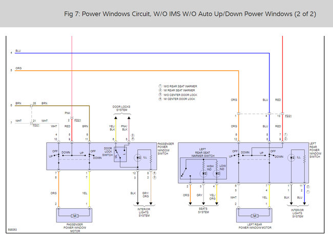

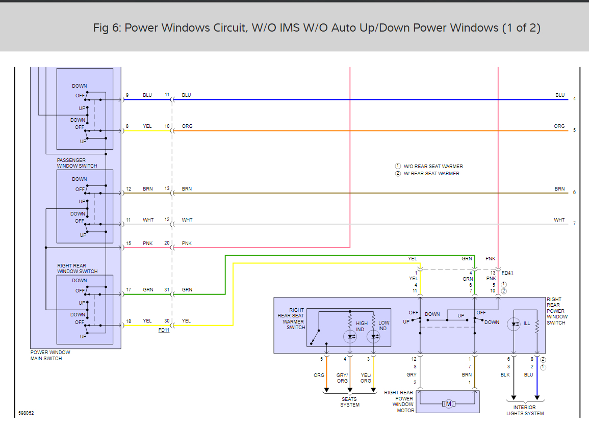

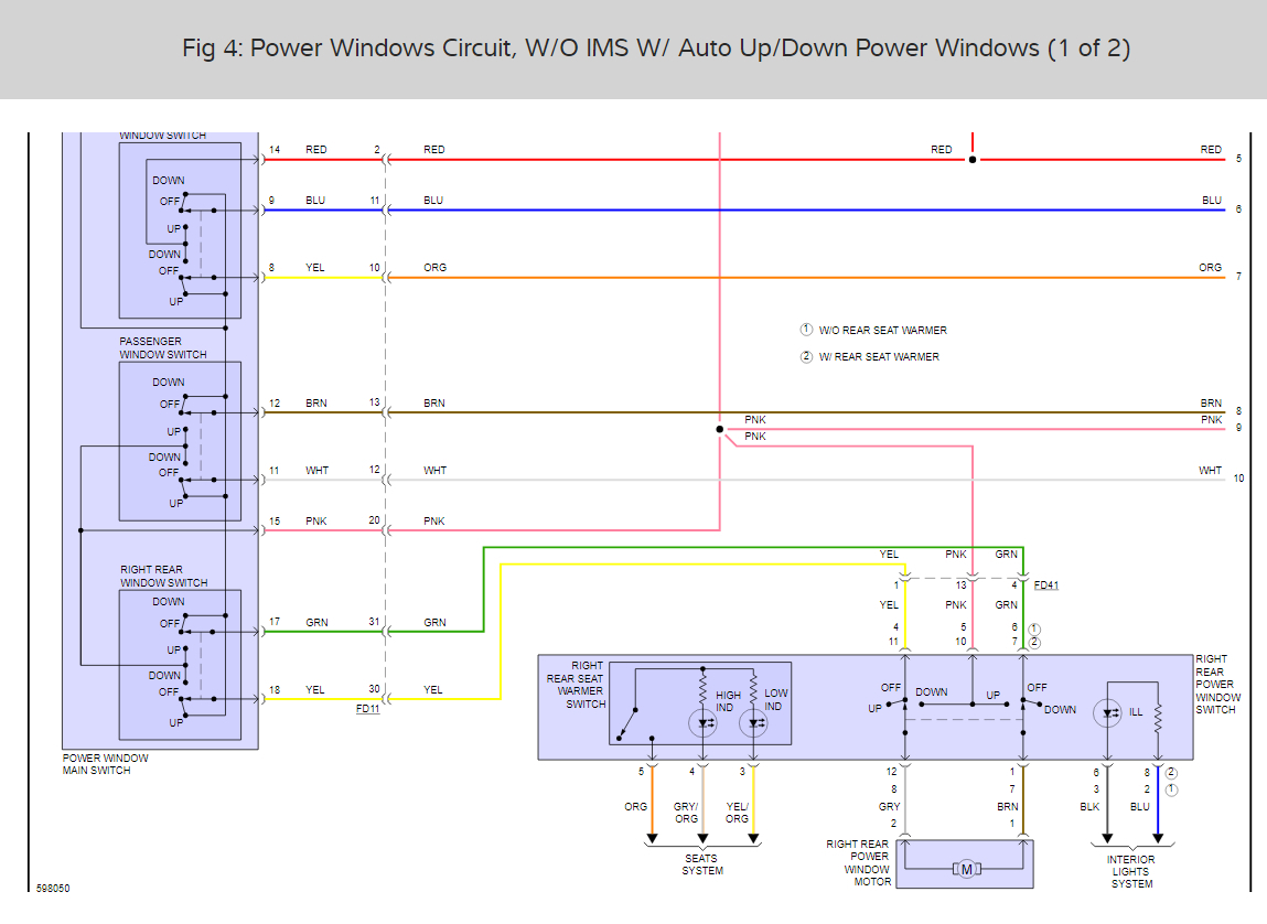

I was not sure which model of power window system is in your vehicle, as there are three different systems available, so I sent you the wiring diagrams for all three systems down below in the diagrams. Please let us know if we can help in any other way.

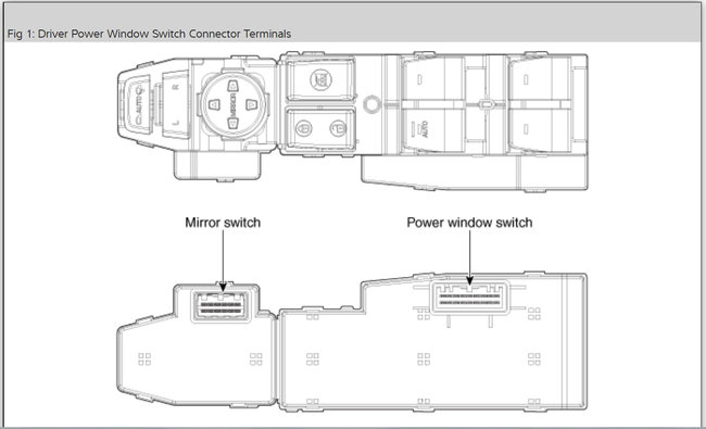

Hi, thank you for your answer, but I need something like this. My car model is Hyundai Elantra AD 1.6 GL MT 2018.

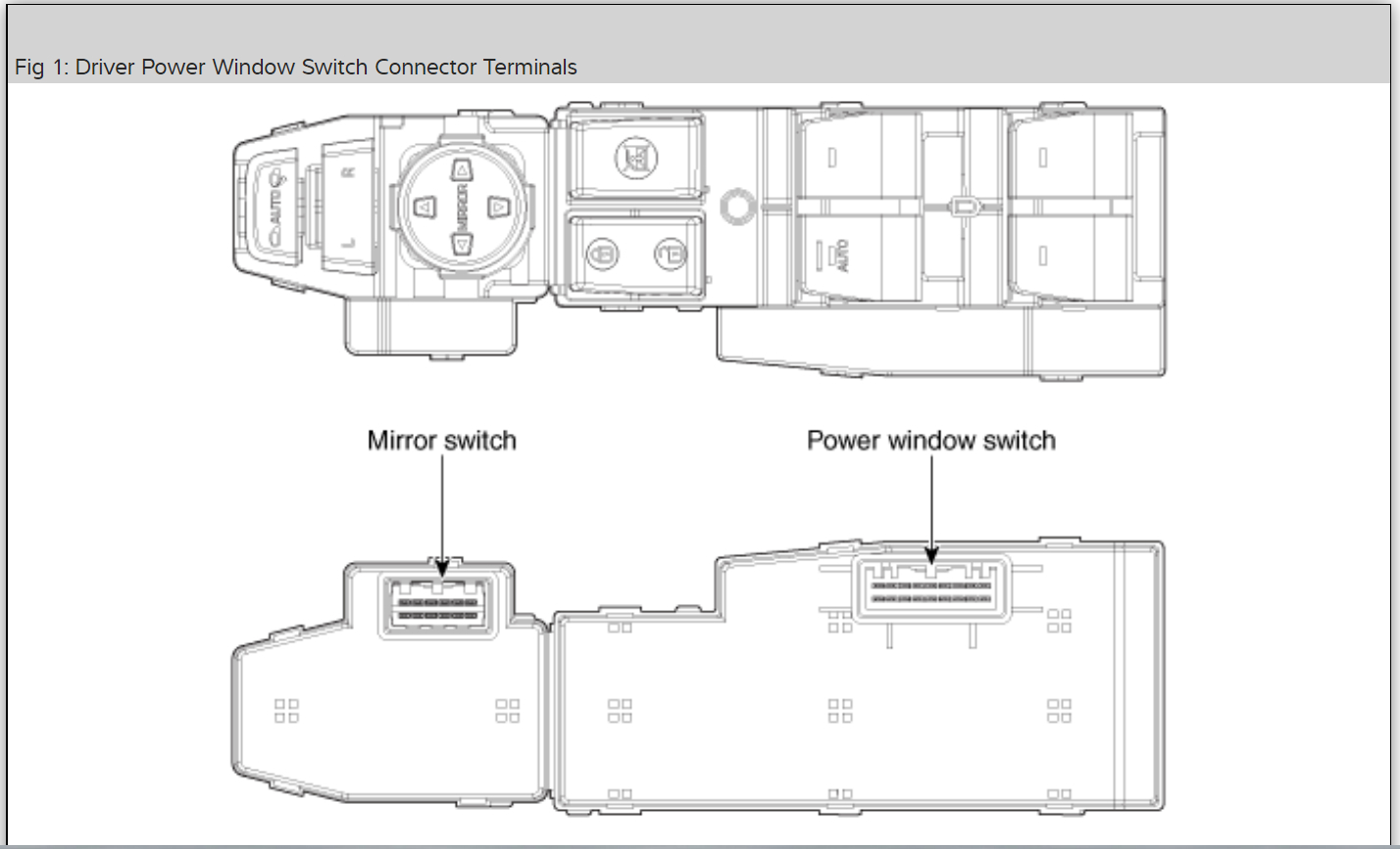

Hello again,

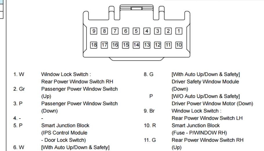

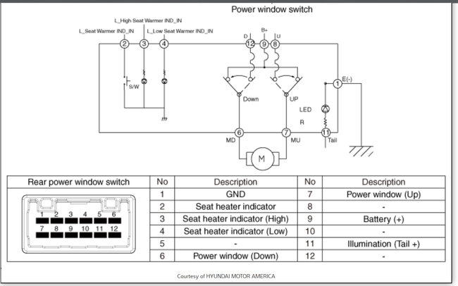

I hope you were talking about the power window switch connector pinouts because I have included those in the diagrams down below for you. There is one for the driver's window, the rear windows, and lastly one for the power assist. Please feel free to ask if you need help with anything else.

ERBEN RENIGADO
Thank you so much Alex, you are such a great help man. :)
