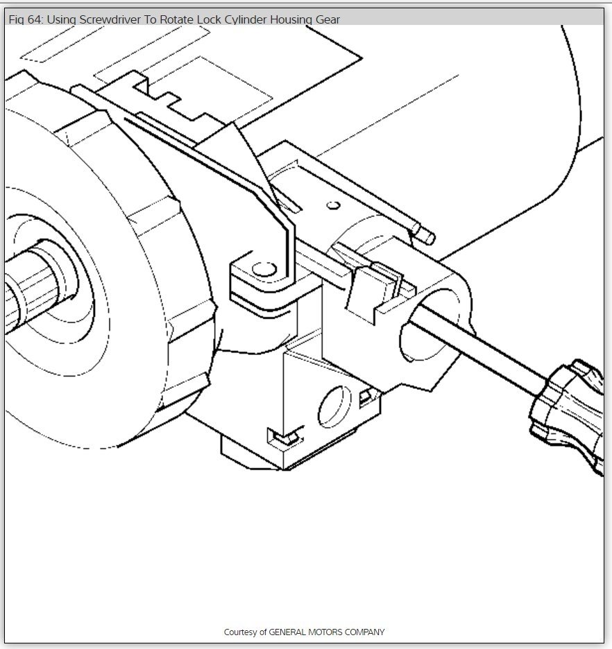

I had the same issue, the problem was the barrel of the ignition key. To be able to move it to the ON position and start the car and remove the barrel I used a small screwdriver and inserted it underneath the key barrel. With some wiggling it turned. In order to get to the bottom of the key barrel you will need to remove the plastic cover on tom and under the assembly.

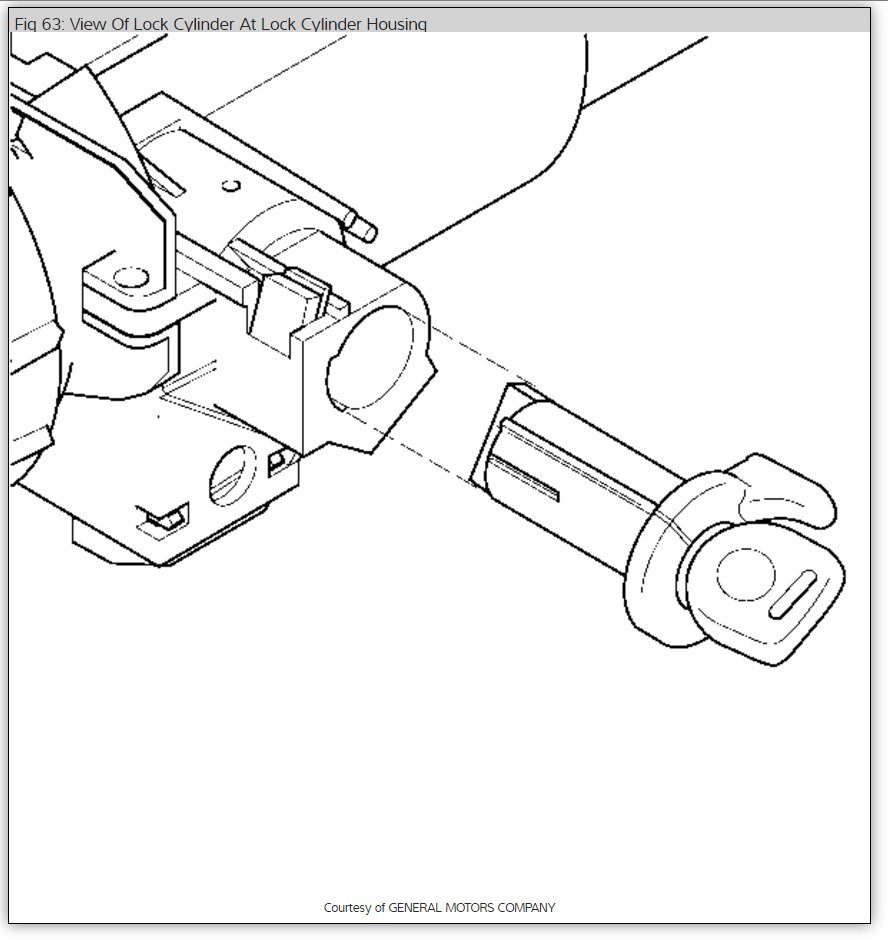

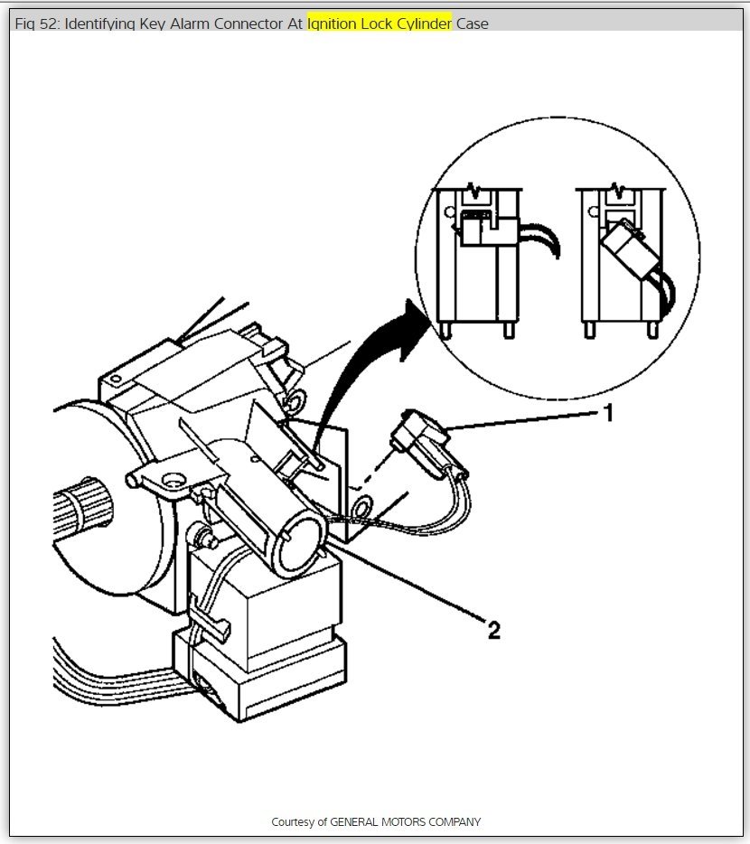

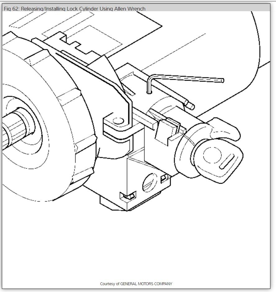

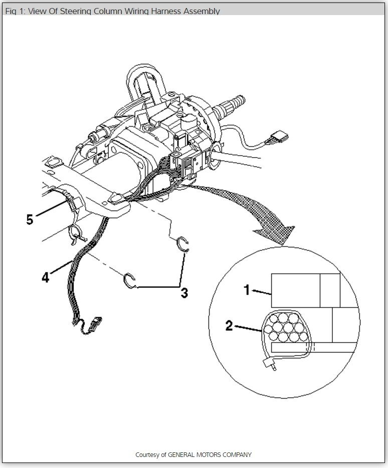

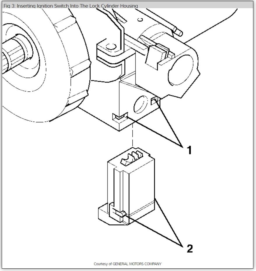

Here is how the job is done so you can change out the ignition key lock tumbler. Check out the images (below). Let us know what happens and please upload pictures or videos of the problem.
