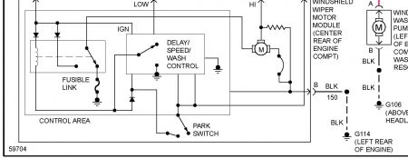

Hi happieboyy, Welcome to 2carpros and TY for the donation Sounds like the wiper motor control module is defective. Been trying to locate that part on the pic but I cannot come up with it on Mit1 and Alldata Auto references its not showing,-sorry Circuit Operation The pulse-type Wiper/Washer System includes an operating mode in which the Wipers make single strokes with an adjustable time interval between strokes. The time interval is controlled by a Solid-State Pulse/Speed/Wash Control in the Wiper Motor Module. The duration of the relay interval is determined by the Pulse Delay Resistance in the Wiper/Washer Switch.

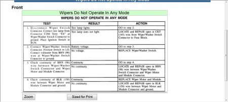

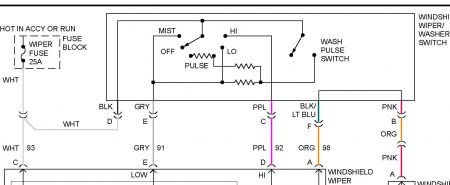

Recheck wiper fuse 35amp again, and check for power when you engage the wiper on the wiper motor pink wire and also test the ground circuit-See below
