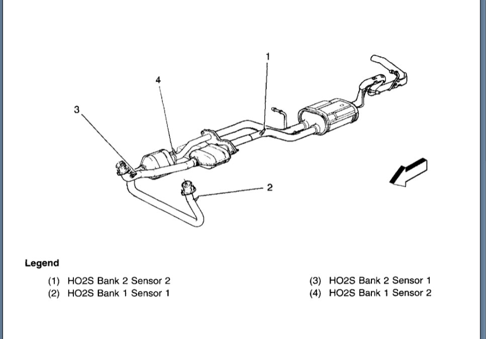

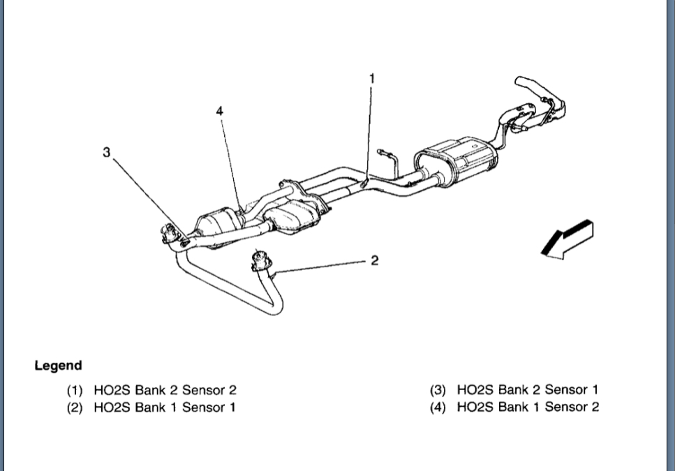

I bought the 4 o2 sensors and would like the locations of them
Friday, January 23rd, 2009 AT 8:01 PM
MECHANIC
18,907 POSTS

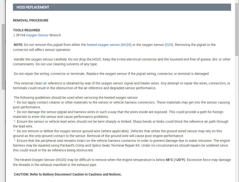

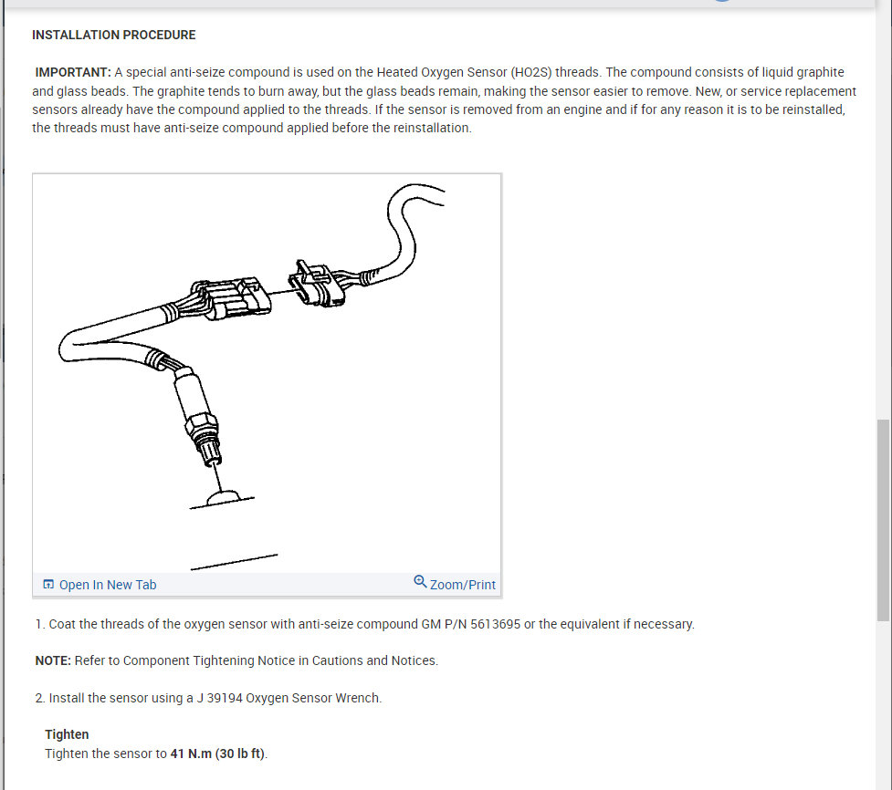

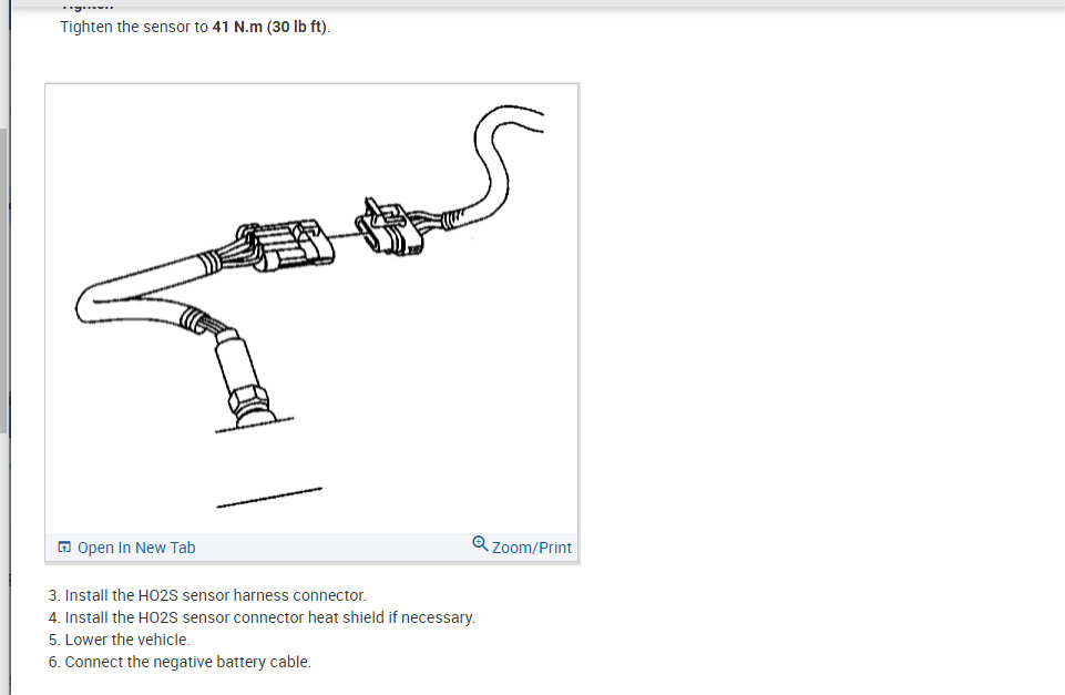

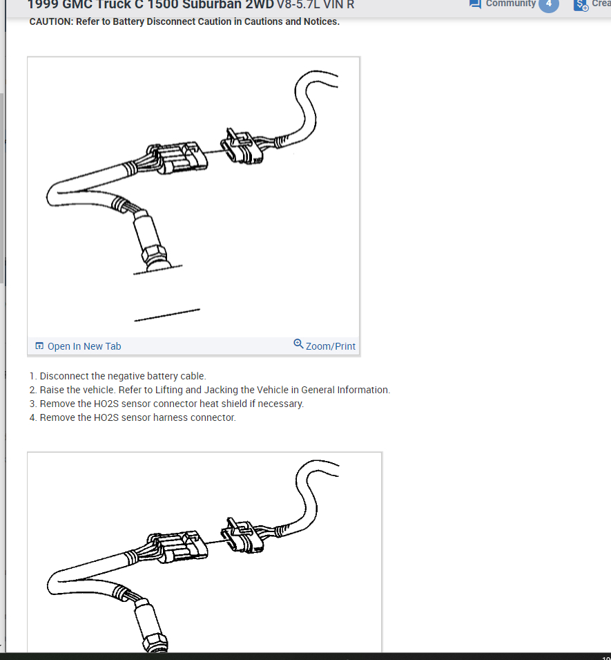

I will attach the info below but here are a number of guides that will help with testing and replacing them:
https://www.2carpros.com/articles/how-to-test-an-oxygen-sensor-02-sensor
https://www.2carpros.com/articles/how-to-replace-an-oxygen-sensor
Below is the process from manual on how to locate and replace these.
Please let us know if you have other questions. Thanks
