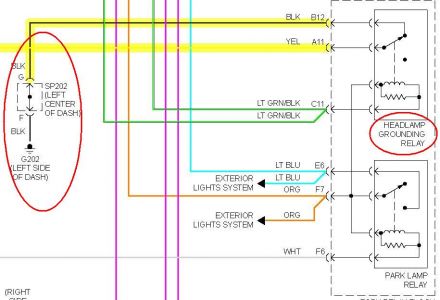

2001 GMC Sonoma JUST HEAD LAMPS
STEVEMC75
  • 2001 GMC SONOMA
  • 4 CYL
  • 2WD
  • 146,000 MILES
http://www.2carpros.com/forum/automotive_pictures/321353_001_1.jpg
Saturday, February 21st, 2009 AT 6:29 PM
5 Replies

All other lights work baseboard, tail lights, flashers, both turn signal left and right work, I even have power at the head lights, leads me to believe there is a ground problem, I have no idea where the head light pic up there ground cause the lights are run in series. Can you tell me where the head lights are grounded. From the Haynes manual it look like through the dimer multi fiction switch but to be honest I have no idea pleas give me some suggestions. Thanks
Steve
Sunday, February 22nd, 2009 AT 6:19 AM
ZACKMAN
  • 4,202 POSTS
https://www.2carpros.com/forum/automotive_pictures/55316_01sonomaheadlampgrnd_1.jpg
Check your headlamp grounding relay.
Sunday, February 22nd, 2009 AT 10:39 AM
STEVEMC75
Is this relay inside the dash board driver side.
Sunday, February 22nd, 2009 AT 6:41 PM
ZACKMAN
  • 4,202 POSTS
Yes it is.
