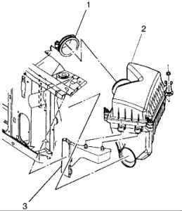

My husband wants to change the air filter in my truck but can't figure out how to get the old air filter off. Can you help?

Removal Procedure
Loosen the air filter housing retaining screws.
Remove the upper air filter housing (2).
Remove the air filter.
Installation Procedure
Install the air filter.
Install the upper air cleaner assembly (2).
Tighten the retaining screws.
