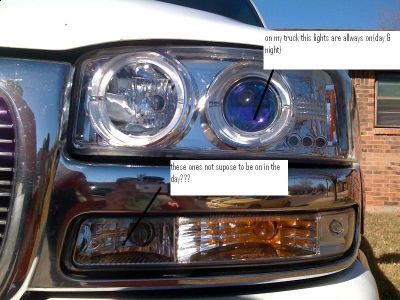

my question is, on my 1999 gmc sierra, my exterior lights(headlight, tail lights) never come off, once I take the parking brake off they turn on even if it's in the day

That is a safety feature and is normal.

Okay, in the first post you said they never turn off when you take off the park brake. THat is normal. Is the problem different?

Okay,first thank you for your patience... i know that is a normal function of the truck, but my question is, in the day must turn on the lights that are under the headlights? and in the night must be the headlights?
https://www.2carpros.com/forum/automotive_pictures/439989_sierra_1.jpg
thank you....

Thank you for your patiences. I appologize, but I'm still confused. I am unable to read what you wrote on the lights. As far as the driving lights, they should be on all of the time when the park brake is off. At night, you neet to turn the headlights on.

Okay. The problem it's that the driving lights never come on. The ones that allway are one are the headlights.

Okay, now I understand. Have you checked the bulbs and the fuses?

Yes. I've checked both.

It must be in the switch.

But, when the parking brake is applied, the headlights are off. I can turn them on manually.

The headlights are the safty driving lights during the day in all Canadian made vehicles. Also several states are using them that way.
