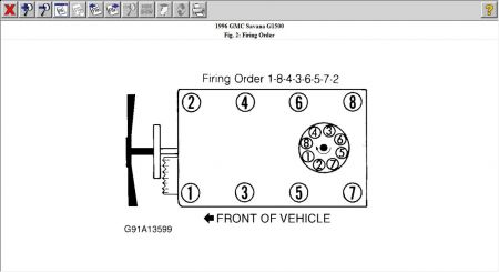

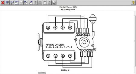

Need a diagram showing the firing order
Monday, August 17th, 2009 AT 7:59 PM
MECHANIC
75,992 POSTS
See below-new and old cap routing-Good Luck
