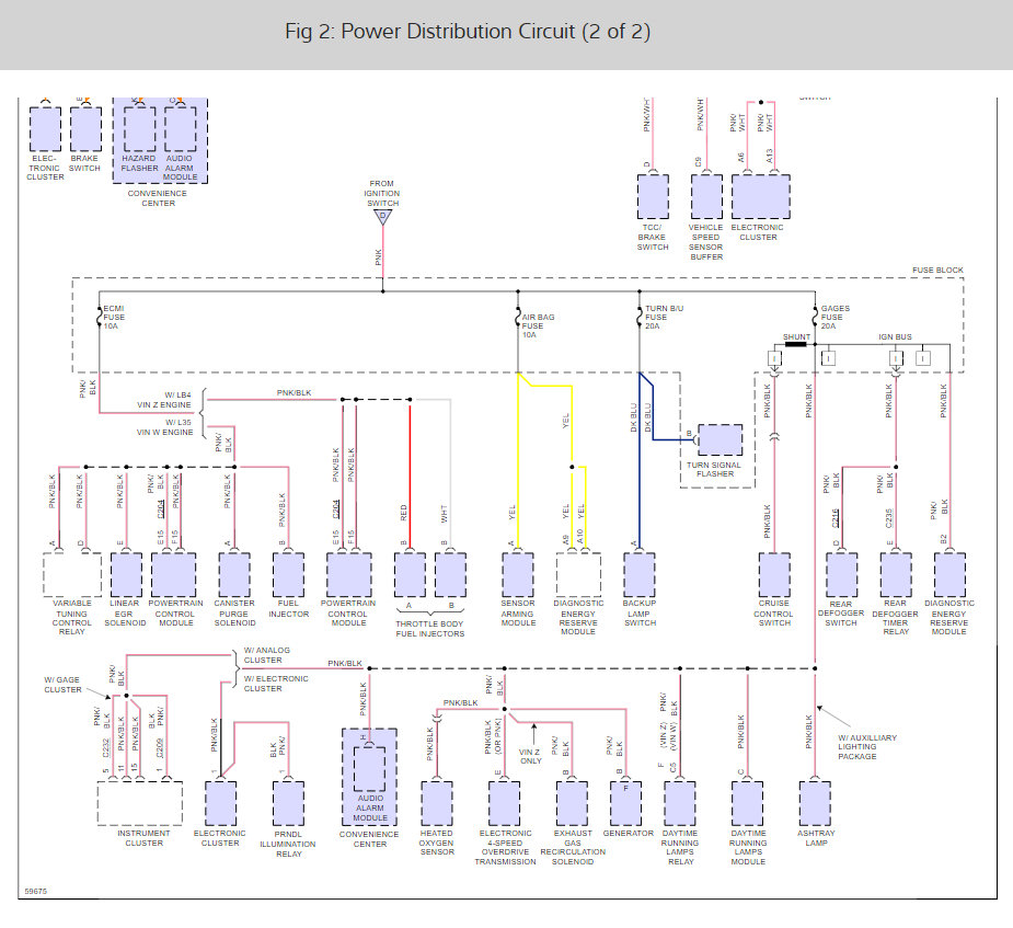

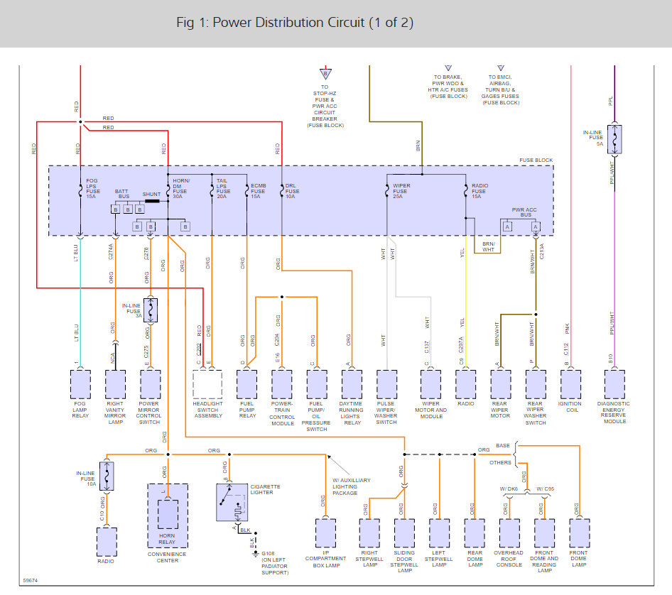

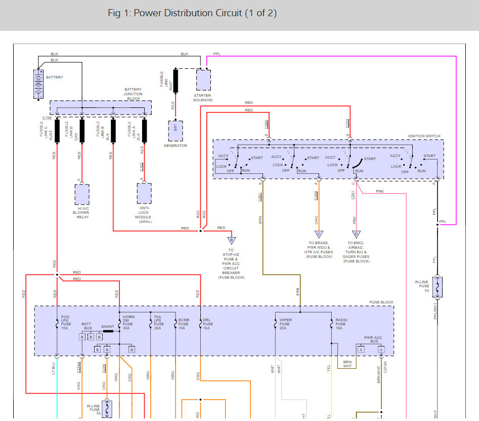

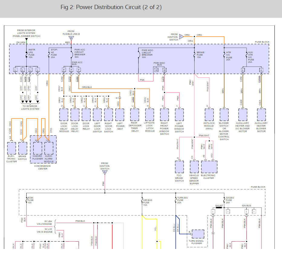

I'm replacing the fusible link connector at the firewall. I got a little ahead of myself by removing the connector. Now I have to figure out where each of the fusible links go. There are (2) 2.0 SQ MM and (2) 1.0 SQ MM going to 4 red wires. One is easy. It goes to the blower motor. Another I can trace to a unit(?) Mounted on the firewall below the brake master cylinder but I don't know what it is. Maybe the ECU? Two go inside to the fuse block. My question is which goes where? And is that unit under the master cylinder the ECU?

Here is the complete power distribution wiring diagram including the fusible link locations and connections. (Below)
